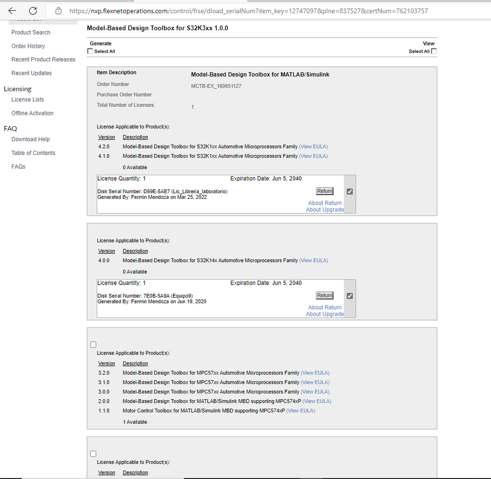

I have a problem with the Mbdtl license for s32k3 I have installed and downloaded MBDToolbox_S32K3xx_1.0.0_20210607.mltbx but when I try to load the "DIO" program simulink gives me this problem License Error: -1, Model-Based Design Toolbox License Missing, please go to The Model-Based Design Development Toolbox Web Site to get a free license or request a demo. Provide the following HostID: xxxxxx
I have searched for the license as I did when I installed mdbtl s32k14 but it appears to download.
The new board that I bought is the S32k3X4EVB-Q172. Is it possible to program it with Mbdtl s32k3? because I have seen that changes have arisen in the hw and in the sw.

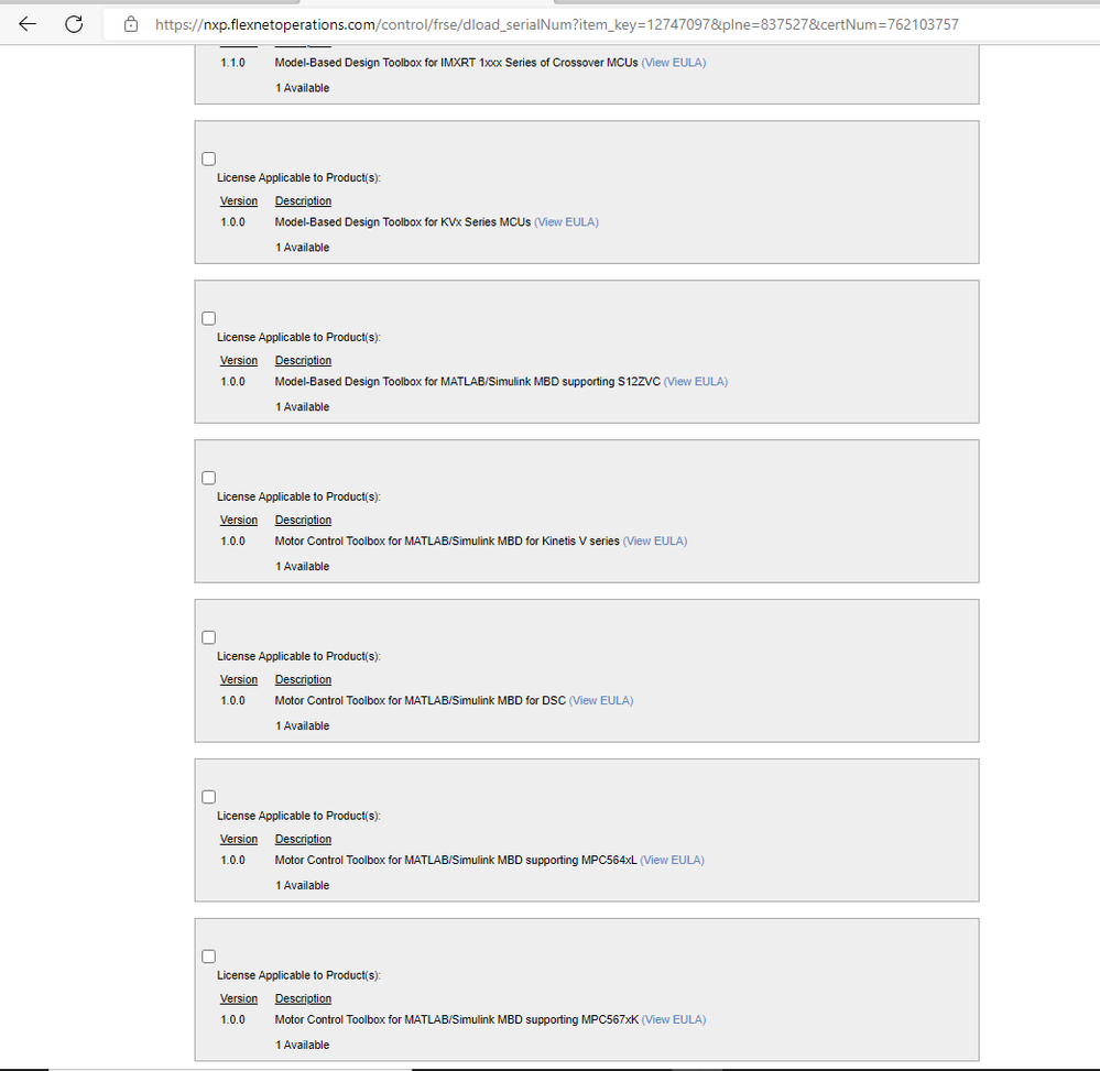

I attach the captures of the licenses that appear on the web

I don't think you have an MBD license for S32K3.
The S32K3 has its own license page and you need to get it from there. You can go to the web with the NXP Support Package S32K3 or go there from the S32K3 MBD download page.
I hope it will be resolved.

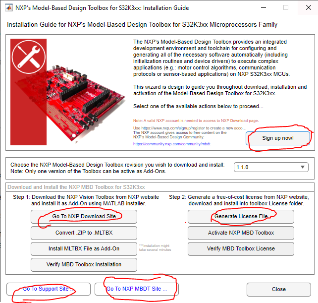

Install the NXP S32K3xx support package but I have another problem when I click on one of the highlighted buttons, in the coman window appear the next message:
Warning: MATLAB could not start your system's web browser:
"cmd.exe" is not recognized as an internal or external command,
executable program or batch file.
I don´t find the website to download the license

If you have not checked this post yet, could you please give this a try? In here you can find the location of the MBDT for S32K3 license, and a step by step described procedure of activating your license.
Also, please note that you are not using the latest MBDT for S32K3, therefore I would recommend upgrading your installation to the latest version (MBDT for S32K3 1.1.0).
Related to the S32K3x4-Q172 EVB, the MBDT 1.1.0 does not provide a default configuration for this hardware part. Therefore, until our next release, which will cover also this derivative, could you please try following the steps described here? You will have to configure your model to use a custom configuration project (as mentioned inside the attached link). This project is also provided in the archive attached to the post.

Please go to NXP.com and regenerate the license for the S32K3xx, providing the right HOST ID.
To find the host ID, please open a Windows CMD line and execute the vol command.
Then please reinstall the newly generated license.
