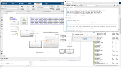

Dear NXP,
I get below error while implementing pmsm model file on MCSPTE1AK344 Kit. The error shows mcat_src_files are not there.
When I checked the Path the mcat_src_files directory has files in it.  Please advise is there any path to be updated in tool. Thanks.
Attached Build Error text file.

C:\Users\Magendran\AppData\Roaming\MathWorks\MATLABAdd-Ons\Toolboxes\NXP_MBDToolbox_S32K3xx\s32k3xx_mc_pmsm_ert_rtw>echo The make command returned an error of 2
C:\Users\Magendran\AppData\Roaming\MathWorks\MATLABAdd-Ons\Toolboxes\NXP_MBDToolbox_S32K3xx\s32k3xx_mc_pmsm_ert_rtw>exit /B 1
### Build procedure for s32k3xx_mc_pmsm aborted due to an error.
Build Summary
Top model targets built:
Model            Action  Rebuild Reason
s32k3xx_mc_pmsm  Failed  Code generation information file does not exist.
0 of 1 models built (0 models already up to date)
Build duration: 0h 0m 53.175s

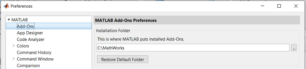

1. error: Add-Ons/Toolboxes/NXP_MBDToolbox_S32K3xx/S32K3_Examples/mc/PMSM/mcat_src_files: No such file or directory
For this one I recommend you install the latest Model-Based Design Toolbox for S32K3xx version 1.4.0 to the following location:
This should be the default location and you need to clean (delete) other folders like C:\Users\Magendran\AppData\Roaming\MathWorks\MATLABAdd-Ons\Toolboxes\NXP_MBDToolbox_S32K3xx\ in order to have only one clean and good location, as in the picture above.

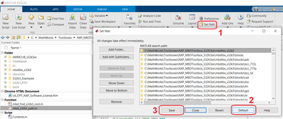

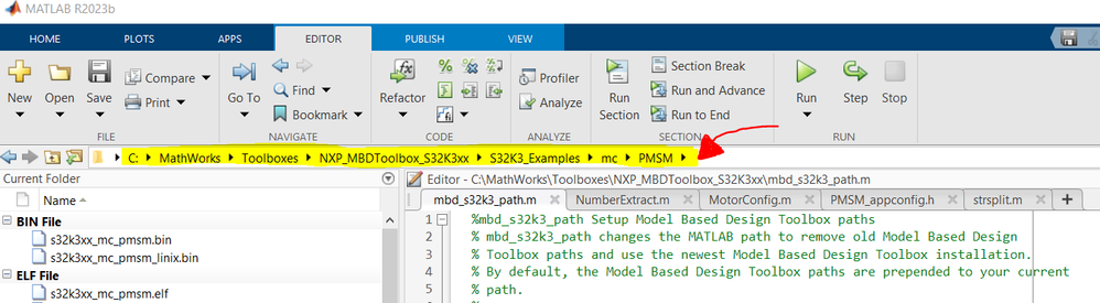

First, I do recommend setting the default path in Matlab, using the Set Path window --> Default --> Save --> Close:

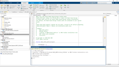

Then navigate to C:\MathWorks\Toolboxes\NXP_MBDToolbox_S32K3xx and run the path script file mbd_s32k3_path.m in the Matlab location:
The output should be as in the picture above, with no errors if all the above steps are followed.
Last step is to navigate to C:\MathWorks\Toolboxes\NXP_MBDToolbox_S32K3xx\S32K3_Examples\mc\PMSM and open the s32k3xx_mc_pmsm.mdl

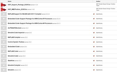

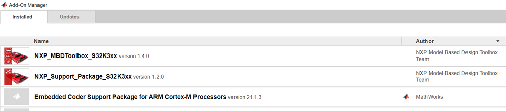

I recommend you install the following Add-ons:

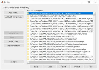

and the following path is set on my PC:
Once again check you have similar paths and Add-on on you PC, they are required in order to successfully build the project.

I have tested and retested using Matlab R2023b Update 6 with the following Add-ons installed:
And reinstalled the MBDToolbox_S32K3xx v1.4.0 and it builds successfully each time, no issues.

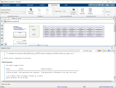

  12. Open the s32k3xx_mc_pmsm.mdl and build it.
  13. If all the steps are ok, then the result should be successfully: stefanvlad_2-1706886384185.pngstefanvlad_2-1706886384185.png

The install path should be as short as possible, for example: C:\MathWorks\Toolboxes\NXP_MBDToolbox_S32K3xx\ this is what it is recommended.
Also, when you run the PMSM example your Matlab folder needs to be: C:\MathWorks\Toolboxes\NXP_MBDToolbox_S32K3xx\S32K3_Examples\mc\PMSM\
Before doing the build process again, please clean up the PMSM folder, keep only the following folders and files:
I have attached here the PMSM folder from my PC,
