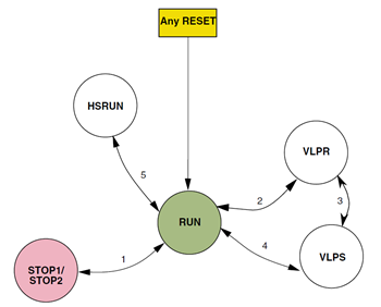

The following diagram shows the power mode transitions. Any reset always brings the chip back to the Normal Run state. In run, stop modes active power regulation is enabled. The VLPR modes offer a lower power operating mode than normal modes. VLPR is limited in frequency.
Power mode state transition diagram (S32K1xx Series Reference Manual, Rev. 4, 06/2017 pag.969)

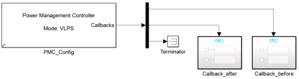

Another important feature that we provide through the new MDBT release is the possibility of automatically call a subsystem "Before", "After" and "Before and after" switching between the power mode selected in the PMC_Config block. The following example shows a PMC_Config block that changes the running mode to VLPS and calls two callbacks: the first one is called "Before" entering the VLPS mode and the second one is called "After" the ISR Handle is executed. The "Before and after" callback is not required so a terminator was added.
