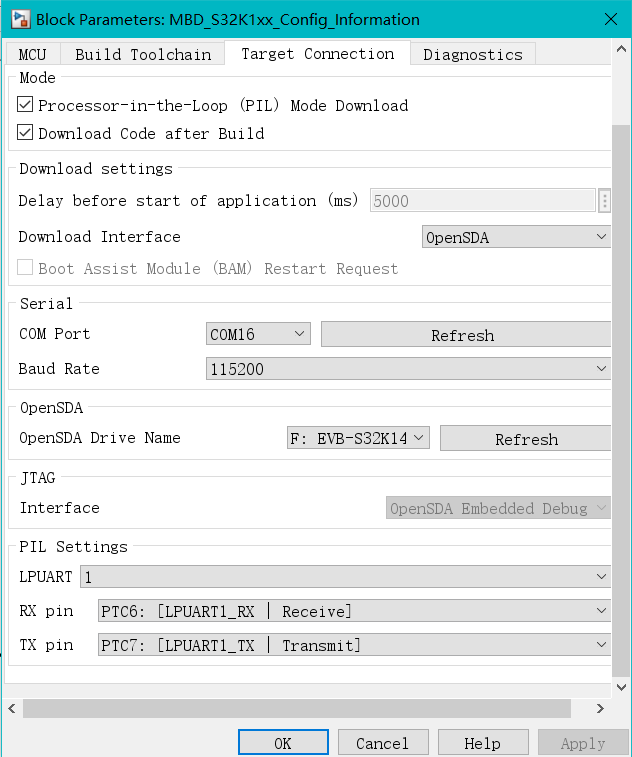

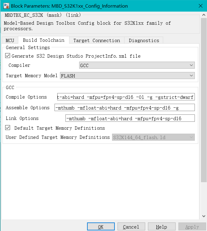

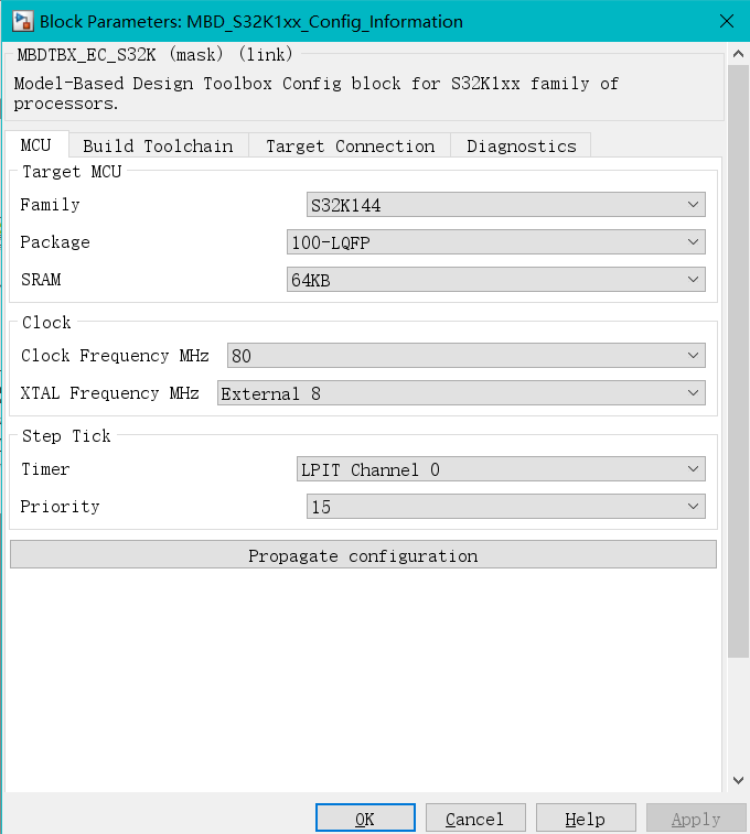

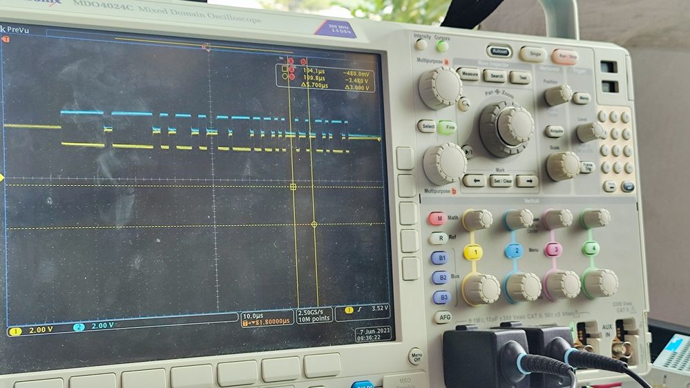

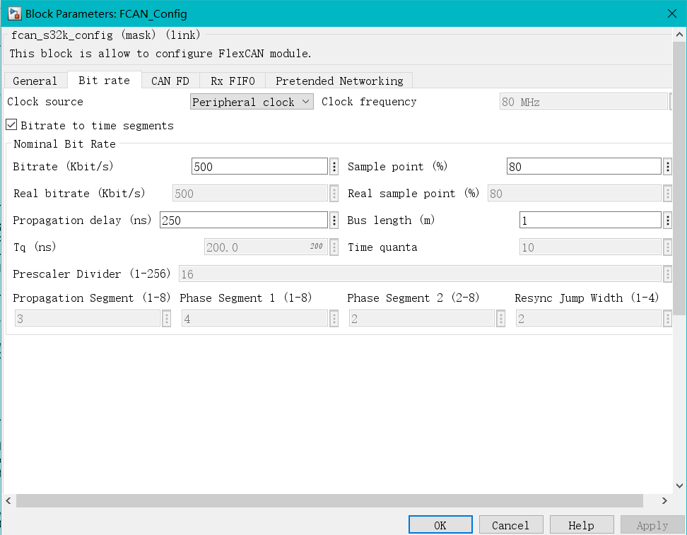

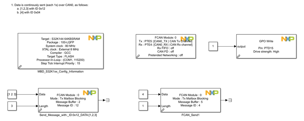

Problem: We are using S32K144EVB with Simulink MBDT Toolbox. We built a basic CAN communication model based on this video: https://www.nxp.com/pages/introducing-the-can-communication-blocks-from-nxp-mbdt:TIP-INTRODUCING-THE... , but there is no output after we flash the program to the board(tested with an oscilloscope). On the other hand, the board has detectable CAN output when we use it with the example can_pal program on S32DS.
Details:
  • J107 Pin1 and Pin2 connected
  • J16 connected to external 12V supply
  • Tried simple GPIO control on Simulink e.g. lighting up the D11 LED. Used a Constant boolean to control the Digital Write Block, the LED only turned on for a very short period of time after the program is flashed(built and downloaded)
  • Also tried example CAN models provided by the MBDT Toolbox on Simulink but still doesn't work
The related pictures are posted underneath, please feel free to ask me for more information or files, thank you!
