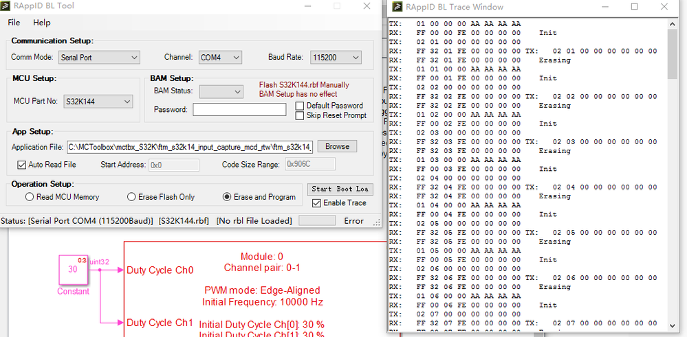

Hi everyone,
  Today,I use RAppID BL Tool download the program into the S32K144,I connect the TXD to PTA2,RXD to PTA3.
After use S32DS flash the SK144_Bootloader.rbf
then I click the Debug
After I power off the mcu.
Then I open RAppID BL Tool download the program.
After I click Start Boot Loa,the window is blank.

After I click the 'start boot loa' button,the RAppID BL Trace Window is always show Init and erasing.Then the error is display.

raduivan
Hi Hongjin,
   Please update the speed field to 115200 not 14400. That is the default speed used by the BootLoader.
Radu
9,092 Views
hongjinzeng
No matter how to set the speed,the RappID BL Window Trace Window show init and erasing.Then I use S32DS flash the elf file,but I find a problem when I power off the MCU,then I power on the MCU,the MCU would delay 5 seconds.How to reduce the time?

raduivan
   You can set the delay time using the "Download Config" panel.
