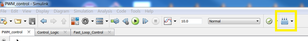

Have you pressed the "Build Model" button ? or you pressed the "Run" ?
13,833件の閲覧回数
tautvydaskarvel
Good day, Daniel,
thank you for your reply. Indeed, I did as you said and I got the same result as had described. However, when I try to follow the tutorials (S32K144EVB Out-Of-Box Experience Based On the FreeMASTER)

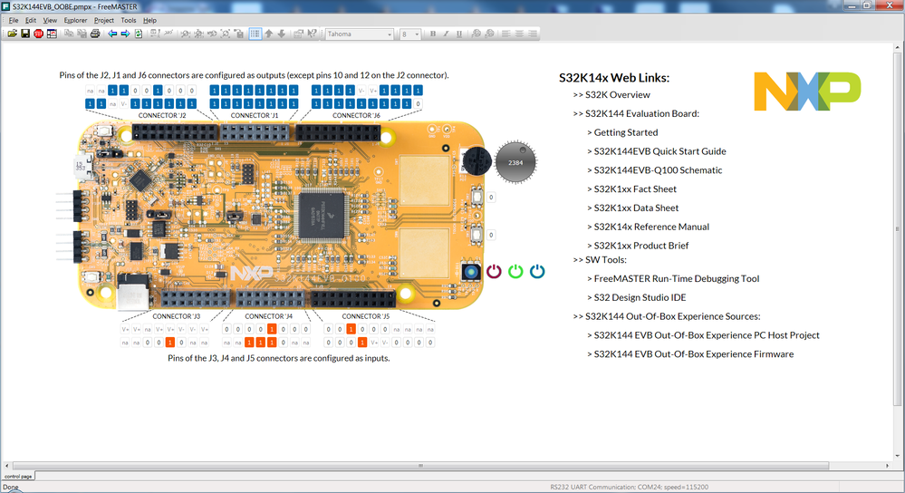

Now that we know the board is working we can concentrate on OOBE demo.

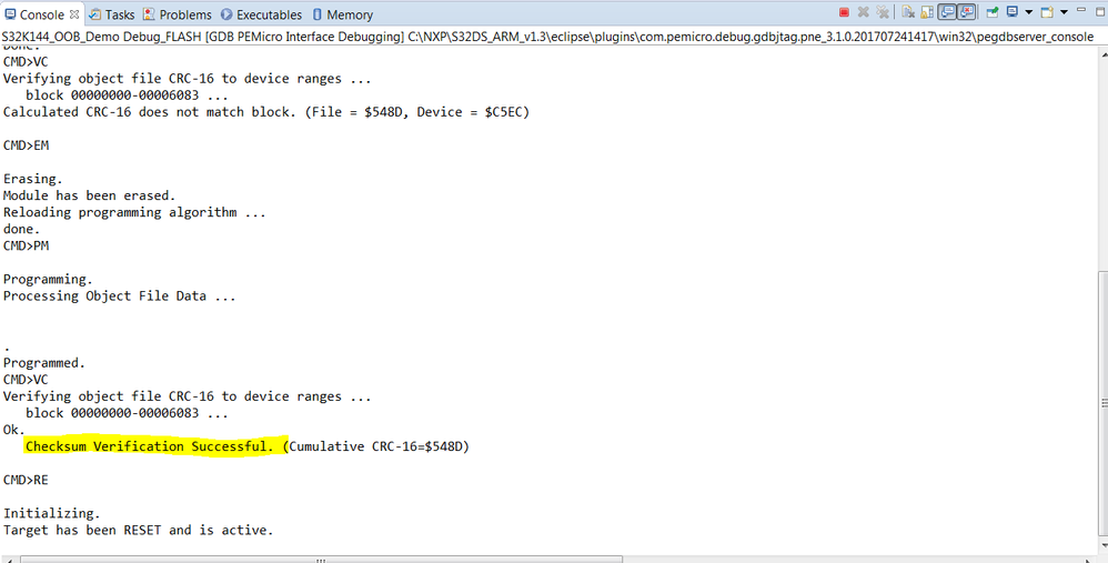

1: download the Embedded Firmware from here: https://www.nxp.com/downloads/en/board-support-packages/S32K144EVB-OOBE-FreeMASTER-Firmware.zip
2: Import the project in S32 Design Studio, Compiler is and then download/flash it into the target. Make sure you disconnect the S32DS after successful flashing and restart the board.
At this point the MCU should be ready to be controlled from the FreeMASTER
3: Donwload the FreeMASTER OOBE application from here: https://www.nxp.com/downloads/en/board-support-packages/S32K144EVB-OOBE-FreeMASTER-PC.zip
4: Open S32K144EVB_OOBE.pmpx
5: Configure the UART connection
6: You should see this screen:
7: Press on FreeMASTER RED LED widget -> the board LED should toggle the RED LED
8: Change the position of the potentiometer on the board. The FreeMASTER Pot wheel should show the value from the ADC.

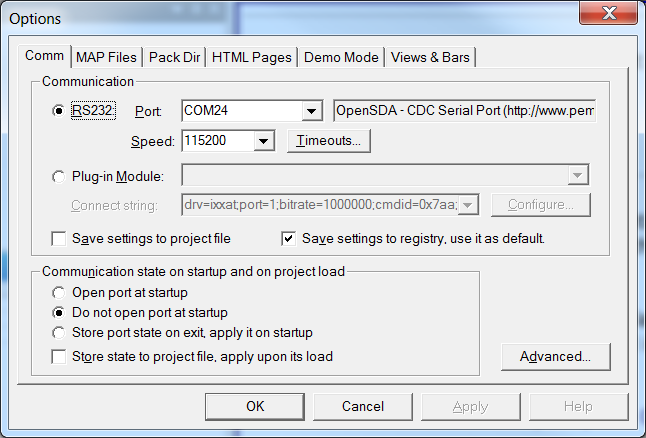

Do you have any pre-program application on your S32K144 board ? FreeMASTER requires the existence of an application on the MCU with FreeMASTER embedded protocol enabled. Otherwise will not be able to communicate since there will be "no one" on the other side.
You can do a simple test by copy-paste-ing the application BLDC_ClosedLoop_s32k14.mot into the S32K144 Mass Storage Driver and then try to communicate via FreeMASTER. (you can check this small tutorial: https://community.nxp.com/message/960388?commentID=960388%23comment-960388 )
Once the *.mot file is flashed correctly in your board (the green small LED near the micro-usb should blink for a couple of seconds and then stay on) you can open the FreeMASTER
and configure the Comm Tab

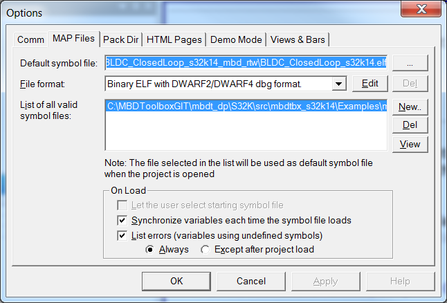

and MAP files Tab by selecting the BLDC_ClosedLoop_s32k14.elf

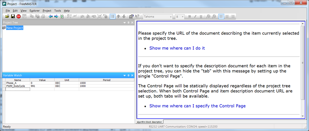

You should be able to see something like if you add the Phase_A and/or PWM_DutyCycle variables in the Watch window.
Can you confirm?
