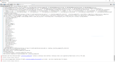

I have custom code integrated into an s-function builder block that builds and links correctly for both normal simulation and for a S32K144 target application with the MBD Toolset. However, when building the block using a model reference for PIL simulation I encounter a makefile rule error in the build process.
I can successfully build and link an application for PIL simulation that does not contain any s-function blocks, and I can successfully build and link (as the attached model c_function_example_sfun_build.slx demonstrates) an application directly targeted to the S32K144 that contains the same s-function builder block.
I've recreated the error with one of Mathworks' example c code s-function builder blocks (attached below), and I've worked with Mathworks' technical support. Their conclusion is that it seems to be a bug in the MBD Toolbox and not in the underlying Mathworks tools.
c_function_example_sfun_build.slx is directly targeted at the S32K144 and builds and links properly, c_function_example_sfun_build_PIL.slx will reproduce the error, in this example:
"gmake: *** No rule to make target `euler2dc_wrapper.o', needed by `c_function_example_PIL_rtwlib.lib'. Stop."
Using the PIL simulation capability would be incredibly valuable to develop and debug the s-function wrapped custom code I am trying to integrate into my project and this is a blocker.

Hi @ericrost ,
I removed the files/paths from Model Settings -> Code Generation -> Custom code as I don't have the libECAS_IO_LIBRARY.a library and couldn't build your model. After that I could build c_function_example_sfun_build.slx.
But I am a bit confused on how you run the PIL simulation for c_function_example_sfun_build_PIL.slx model. Can you tell us how you run the PIL simulation?

I ran the PIL simulation in c_function_example_sfun_build_PIL.slx and even though it found the euler2dc_wrapper.o file I still got an error:
It looks like on your side it fails when it tries to build c_function_example_PIL_rtwlib.lib and can't find euler2dc_wrapper.c to build euler2dc_wrapper.o.
Can you send a zip archive with the generated folder slprj to take a look over it?
I tried with a clean install of the S32K toolbox version 4.2.0. Which patches did you apply?
Paul
12,616 Views
paulvlase
Ignore my last message. It could build euler2dc_wrapper.o on my side because there was a file with the same name in my Matlab installation folder. After I renamed that file I got the same error as you.

@paulvlase, this does resolve my build error, however you should be aware that this patch breaks your consistency checks by hardcoding an incorrect platform, as indicated in this error (which does not stop the build process):
"Failure in mbd_s32k_consistency_checks(line 0) : Undefined function 'mbd_s32k_ssd1306_block_check' for input arguments of type 'char'."

@paulvlase, That is the entire problem, I cannot build this for a PIL simulation.
It is set up with a model reference to c_function_example_PIL.slx running in PIL, so there is a target configuration block to connect to COM7 UART and run that code on the S32K144, using the inputs provided by c_function_example_sfun_build_PIL.slx. However, when attempting to build and deploy for PIL simulation, the build errors occur.
