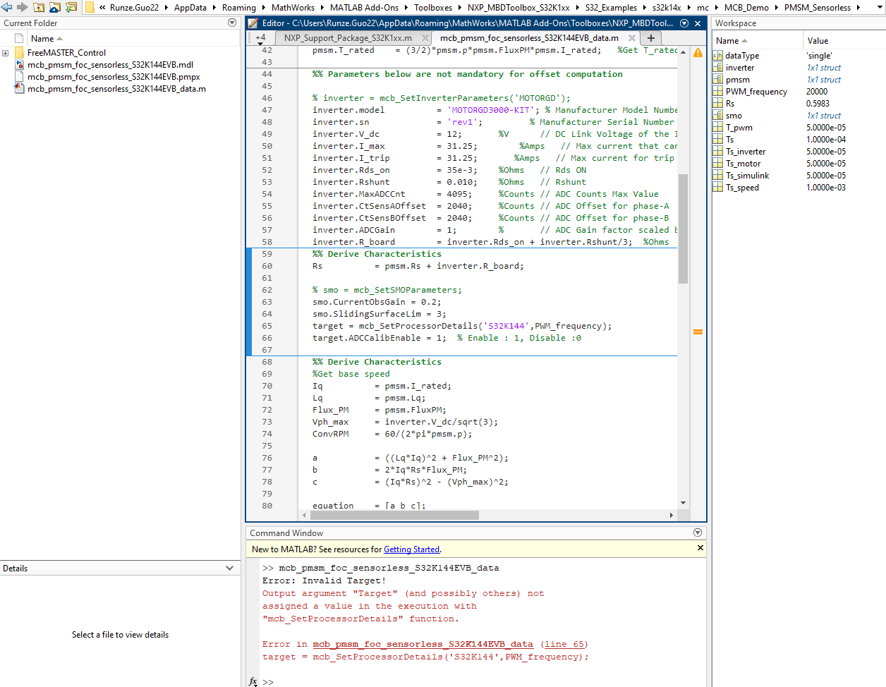

I would like to validate PMSM sensorless speed control algorithm in the S32K144 development kit with the ‘MBD Toolbox’. But after downloading it from Matlab ‘adds-on’, the .m script cannot run. It shows some errors. Have you found this issue, or how can I solve it to make the related model run?

Hello @Chiper
According to the error reported, I think the missing package from your setup is the Motor Control Blockset, a toolbox provided by MathWorks. Please find additional information here: https://www.mathworks.com/products/motor-control.html

Hello Marius:
Thanks for your reply. This is not because I have already installed this block set.
Could you please help to check again?
