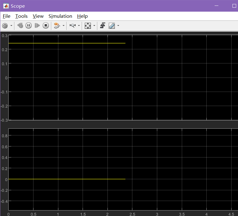

The workflow 1 and 2 work well, the motor can run and I can observe signal in the scope. But in workflow 3, I built target model first (Figure 1), then when I run the host model (Figure 3), the motor cannot run. And all of the signals in the scope is like Figure 2.

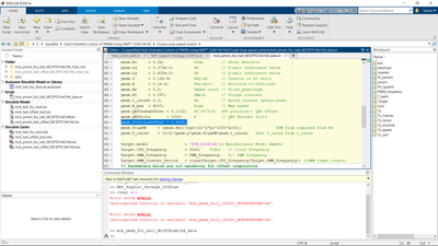

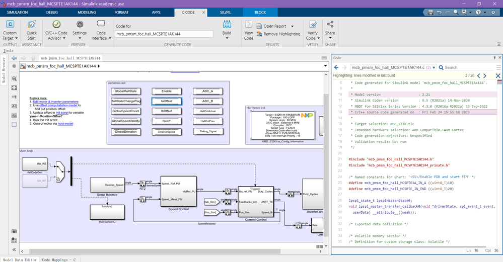

 mcb_pmsm_foc_hall_MCSPTE1AK144 - Simulink academic use 24_02_2023 16_00_26.pngmcb_pmsm_foc_hall_MCSPTE1AK144 - Simulink academic use 24_02_2023 16_00_26.png
Figure 1
Figure 2

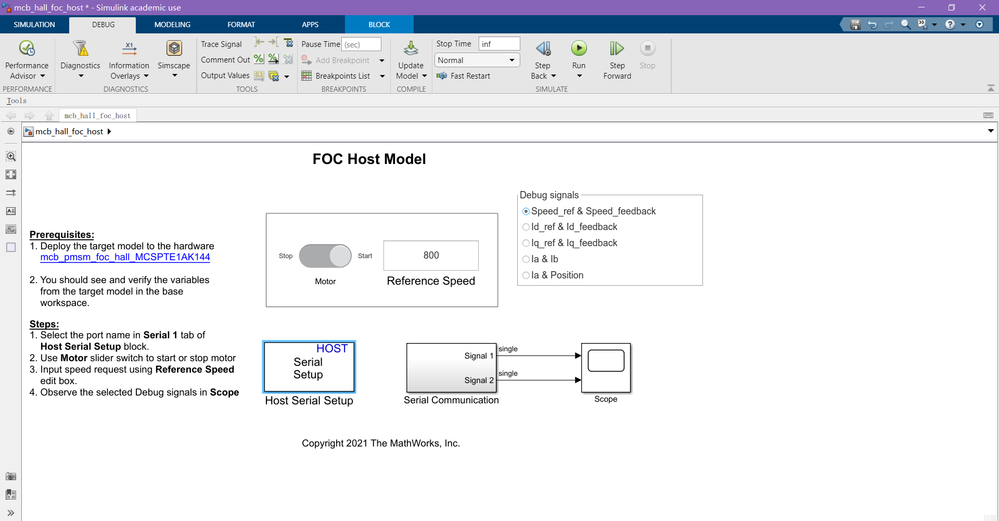

mcb_hall_foc_host _ - Simulink academic use 24_02_2023 16_37_25.pngmcb_hall_foc_host _ - Simulink academic use 24_02_2023 16_37_25.png
Figure 3

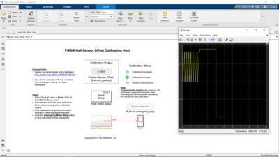

Workflow 2
From all of the above I find the workflow 2 very important since this will impact the Speed control of the Motor.
In my case, I had to change two motor phases, in order to change the rotation direction for the calibration:
Then I have added this value into the mcb_pmsm_foc_hall_MCSPTE1AK144_data.m script:
Then I save and run the mcb_pmsm_foc_hall_MCSPTE1AK144_data.m again.

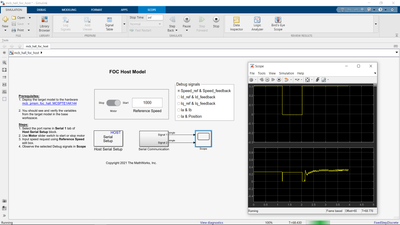

Opening the mcb_pmsm_foc_hall_MCSPTE1AK144.slx model, I flashed it on the S32K144 board, pressing Build ( or Ctrl+B on keyboard):
Then opening the mcb_hall_foc_host.slx model and open com port settings, and setting COM4:
You can see in the device manager what COM port your particular board has.
Then I press Run and also toggle from Stop to Start. If the motor does not Start, press the reset button on the board.
The final result with the motor spinning, after pressing the reset button on the board, looks like:
