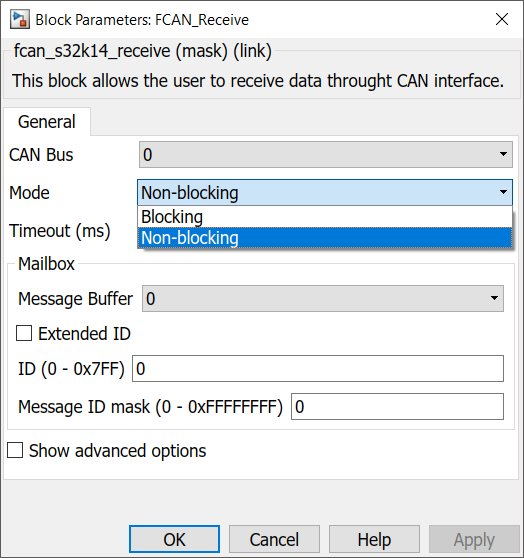

I have some questions about Model Based Design Toolbox for S32K Series :
1.Why FCAN_Receive block doesn't have any output ports? How could I get data output?

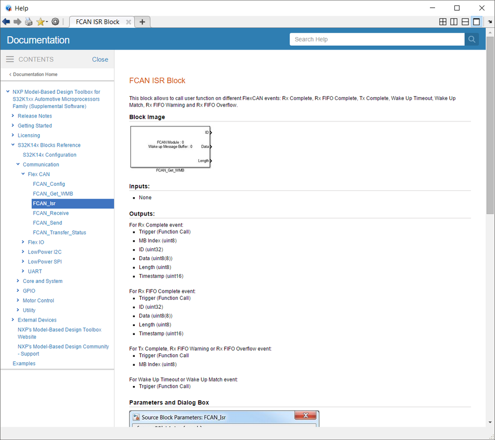

2.What's function about FCAN_Isr block?I couldn't find any instruction or intro about FCAN_Isr.

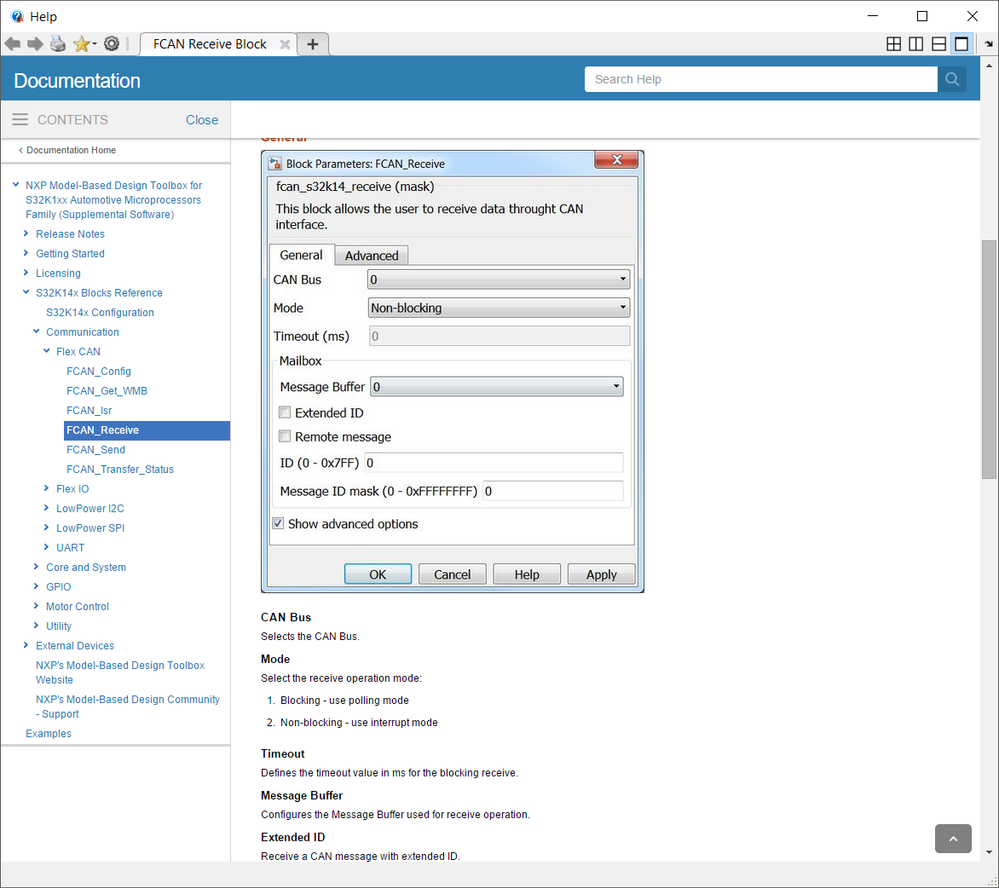

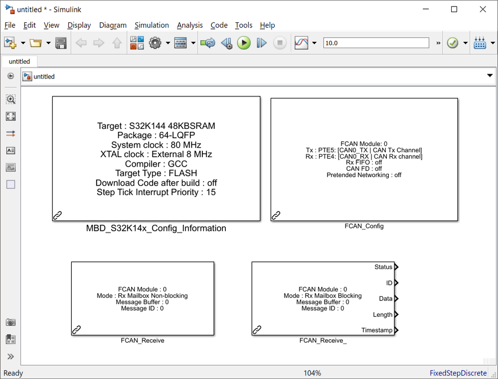

The FCAN Receive block allows you to use 2 modes of operations:
  • Transfer Mode: Non-blocking
  • Transfer Mode: Blocking
Depending on the selection within the mask the block is updated to reflect it's status:
If might show up with or without the data output ports:
If you check the MATLAB help associated with the block you will learn more when to use one mode or the other.
Which toolbox version are you using? 1.0.0, 2.0.0, 3.0.0 or the latest 2018.R1 ?
Here is a capture from the latest version 2018.R1
