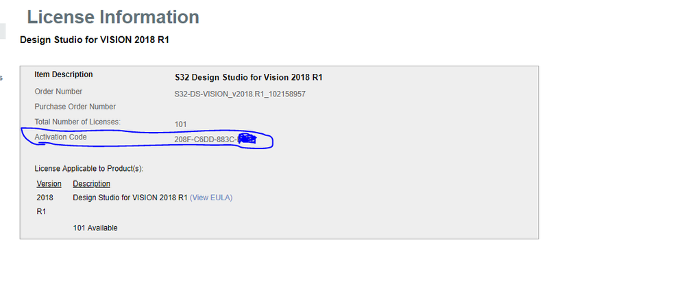

      Hello everyone! I'm installing "VSDK and A53/APU Compilers" followed the "VisionToolboxQS.pdf", but I can not find s32ds activation code anywhere. I checked my email, it doesn't contains the activation code.
Besides, in my product list, it shows not requiring a license key. How can I continue the installation?

Hi Razvan,
Thanks for your help, I have solved the problem.
The  activation code for S32 Design Studio for Vision 2018 R1 did not work, the tool I'm installing requiers the APU compiler, so the S32 Design Studio > Vision Extension Package for S32V2xx v1.0.0 worked.

Hello [email protected]‌,
If you are looking for the activation code for S32DS, you can find it in your products list on www.nxp.com.
You have to search for the S32DS, go to the Download page, and from there select License Keys.
Please let us know if you have further issues with this.

Hi Razvan,
I was not sure what product you needed - sorry. Glad to hear that it worked!
