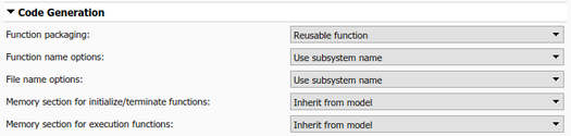

jimfreudenberg
Hi, and thank you for your help!  It has taken us along time to respond because oyr students are very busy with the end of the semester.
Selecting "Reusable Function" no longer causes an error -- thanks again!
However, we also (see attached screenshot1) want to select two additional options so that the nerated code has functions in separate files (see screenshot2). Unfortunately, thos causes erros again.
these screenshots are from the instructions that we give students, so they can see how to customize code to improve readability, and it would be great if they would work -- it appears as though additional fixes are need though.
It would be great of you could help us out again, and thanks in advance!

mariuslucianand
Hello @jimfreudenberg
I am sorry for my delayed answer, I might have missed this community post.
You are right, the issue comes from the quadrature decoder block. For some of our blocks, like FTM we generate dedicated C source files and headers for declaring the configuration structures for peripherals. The issue comes from including the model_private.h header in some of them.
For this particular case, I have removed the include line from the generated code and on my machine, the model which is using qd builds successfully. I have attached a tlc file that must be replaced in our toolbox ( please backup it first).
To do so, please type the following command in Matlab: winopen(fullfile(mbd_find_s32k_root, 'mbdtbx_s32k\blocks\ftm')) This will open the exact file location of where the attached tlc must be replaced. Please give it a try.
For now, I've only added the qd file but most likely we might have to change all FlexTimer blocks with this fix.
