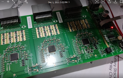

Dear NXP team,
RD33771CNTREVM_Board_Initialization_Problem
please see the information from the customer in the attached files.
1. Pure C Project folder; customer use example from NXP, the result of reading voltage is not correct (please see the pictures).
2. Simulink Project; They try to use Matlab Simulink to generate code, the result of EVK board is not responding to anything.
Thank you.

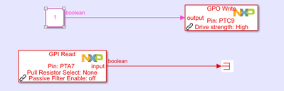

3. The PINs of EN and Wakeup Have to be initialized in the MBDT like below.
4. For writing the CSB pin you can use the LPSPI_DRV_SetPcs driver function.

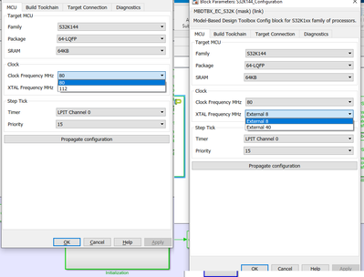

The below is a reply from the customer.
1) the setting of 48MHz is not available at all.
48MHz is not setting parameters in Simulink, it is the system frequency of uC.
The settings inside Simulink are Clock (Oscillator usage) related, it has only 80/112MHz and 8/40MHz.
After that, the uC will use this parameter to configure. Internal frequency to be 48MHz which will be used in the GET_CLOCK_FREQUENCY function.
This function, yes, relates to the wakeup procedure due to waiting time.
2) In other parallel project, NXP FAE send me the example project which uses the below INT_SYS_SetPriority function to increase SPI priority. I follow him already, but not work.

PhilippePerruchoud-NXP
Not sure what correct voltage values are expected, but from the picture in the zip file, I can see that the physical value of the voltage doesn't correspond to the raw value because the cell resolution factor was not applied. In the datasheet, this factor VCT_ANX_RES is 152.58789 µV/LSB.
For the VC14, raw value measured is 1E5F which corresponds to 1.186 V
Hope this helps
