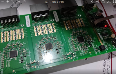

Dear NXP team,
RD33771CNTREVM_Board_Initialization_Problem
please see the information from the customer in the attached files.
1. Pure C Project folder; customer use example from NXP, the result of reading voltage is not correct (please see the pictures).
2. Simulink Project; They try to use Matlab Simulink to generate code, the result of EVK board is not responding to anything.
Thank you.

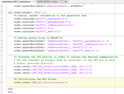

Hello @Wittawat ,
I had a look at the attached code. As far as I've seen, there are used older driver version of the mc33771 driver. I've could not quite understand how to the Wakeup is meant to work, because the wakeup procedure is toggled every step time.
Unfortunately, I don't have access to the RD33771CNTREVM so I cannot give this a try on hardware.
My suggestion is the following. Go to this article, and below the page, you will find an archive with the startup model for the MC33771C with the latest driver. Please start from there: https://community.nxp.com/t5/NXP-Model-Based-Design-Tools/How-to-use-your-own-C-code-in-our-Toolbox-...
For the attached code, I have the following comments:
1. The board MCU frequency is 80MHz, not 48 as I've found in the code.
2. The SPI interrupts priorities have to be increased, as you can see in the attached archive of the mentioned article.
3. The PINs of EN and Wakeup Have to be initialized in the MBDT like below.
4. For writing the CSB pin you can use the LPSPI_DRV_SetPcs driver function.
Hope this helps,
Marius

2) In other parallel project, NXP FAE send me the example project which uses the below INT_SYS_SetPriority function to increase SPI priority. I follow him already, but not work.
The difference is that he is also using this increase priority to PIT_CH3 for some kind of busy waiting.
But I have not understood him, but I already asked a few days (No reply).
So I have no idea which more priority I have to increase yet.
Could you please advise on this case?

Not sure what correct voltage values are expected, but from the picture in the zip file, I can see that the physical value of the voltage doesn't correspond to the raw value because the cell resolution factor was not applied. In the datasheet, this factor VCT_ANX_RES is 152.58789 µV/LSB.
For the VC14, raw value measured is 1E5F which corresponds to 1.186 V
Hope this helps
