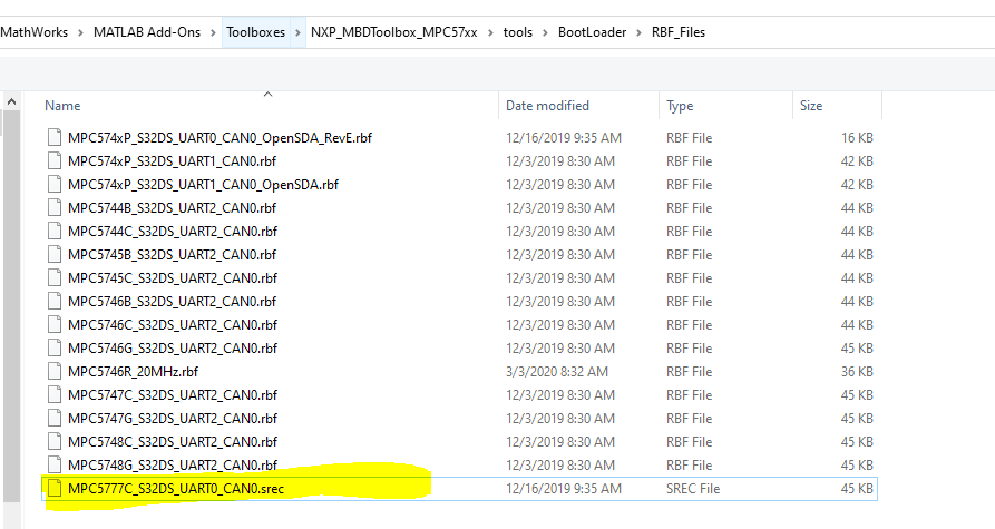

Hello All,
I am very new to NXP, I am trying to study MBD example uart_hello_world_mpc_5777C example MPC5775B/E-EVB board. Which boatLoader file should I flash from BootLoader -> RBP_Files folder. I tried to flast MPC5777C_S32DS_UART0_CAD0.srec. I do not see any other file with MPC5777C.
Let me know if I misunderstood anything.

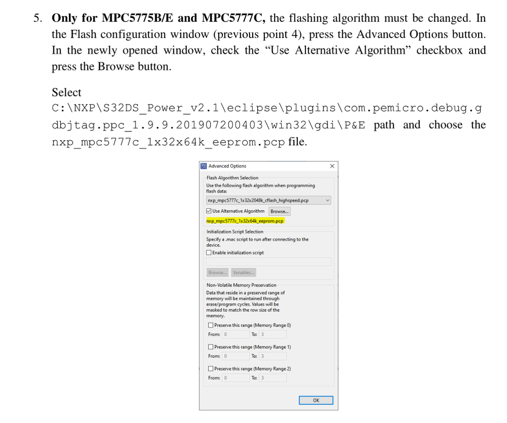

Hello @snehalshinde ,
That's the file, but you have to do an extra step in the S32DS for the MPC5777C as described below in the Quick Start Guide. You can find the entire document inside the MBDT toolbox installation folder.
Hope this helps,
Marius
