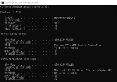

My customer reported following issue:
I get an error while using the add_mex(1i,1i,0,0) function to verify the license.
My Host ID: 70-B5-E8-81-D0-8A.
ERROR:
SPTToolbox: License error.
错误使用 link_mex
MEX 文件 'C:\Users\Administrator\AppData\Roaming\MathWorks\MATLAB
Add-Ons\Toolboxes\NXP_RADAR_Toolbox_for_S32R\mex\sim\sim_spt20_mex.mexw64' 无效: 动态链接库(DLL)初始化例程失败。
Peter
2,478 Views
iulianbulancea
As a Host ID, instead of Ethernet Address can you use Disk Serial Number? You can find the Disk Serial Number by calling in the command line vol C:.
