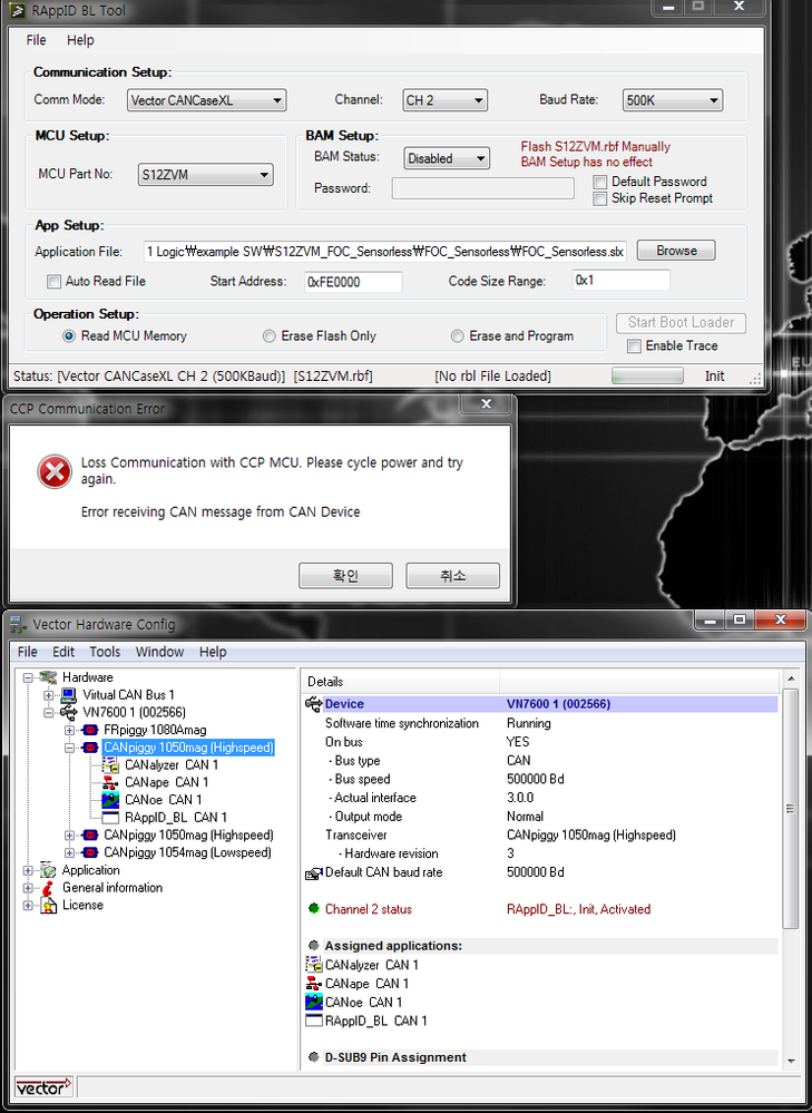

eungsoolee
Hi Daniel
I am always thankful for your kindness.
I proceeded as you advised yesterday, but the connection was not successful.
Questions
1. To explain what I have done,
Step1~3 : I checked Step 1 ~ 3.
Step 4~5 :
       I have already read RAppIDBL_UserManual.pdf and have configured the Vector HW Configuration.
       When running the Start Boot Loader of the RAppID BL Tool, the message "RAppID_BL :, Init.Activated" appears in the Channel 2 Status of the Vector HW Config window. However, the BAppID BL Tool outputs the following message.
Is there anything else I should check it?

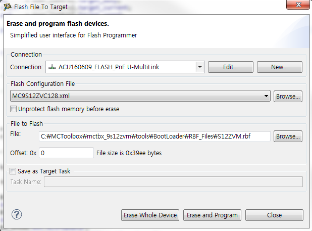

2. In the document "Motor Control Toolbox for MagniV_Matlab_simulink modeling and code generation", The first step is to load the flash bootloader using CW Flash Programmer.
  The following message appears in the CW console window.

Is the file flash correct?

Daniel_Popa
Hi eungsoo Lee,
Regarding #1, i see you have done all the configurations correctly. I think is safe to say that RAppID BL is not currently supporting the device you are using and that is the main reason for the failure your are seeing.
You might want to add a service request to ask for a new feature to add support for other Vector Devices like yours here: Sales and Support|NXP at Support Requests
Is is a hazard to add a serial port on your board ? or to get another CAN device that is officially supported by our application ?
Regarding #2,
It should be ok. That address belongs to the vector table but the interrupts gets disabled in the Bootloader - so may not be a problem.
Hope it helps!

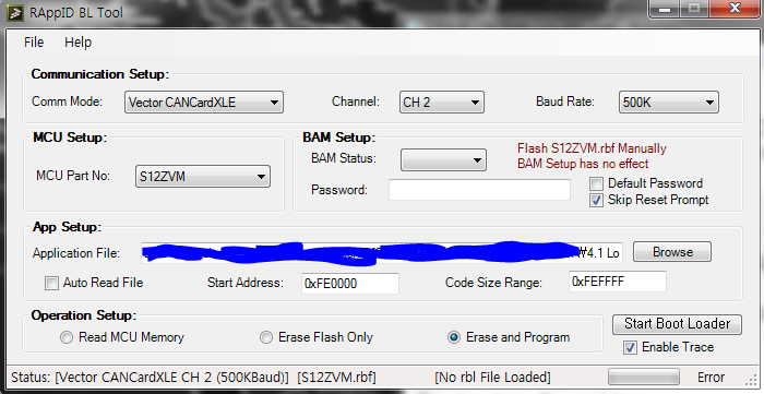

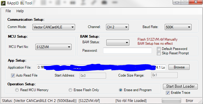

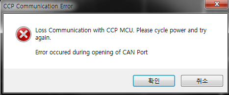

eungsoolee
Thank you for your answer.
But I have not been able to connect to my board yet.
please Check the my RAppID BL Tool window
(CAN Test SW downloaded with Jtag works well...ㅠㅠ)
Comm mode : Vector CANCardXLE
Channel : CH2 (CH1 of VN7600 is assigned to FlexRay.)
Raud Rate : 500k
When I run the Start Boot Loader button to display the following message.(ㅜㅜ...)
Question
1. when you connect using VN1610, Is Comm Mode set to Vector CANCardXLE?
2. Is there any other way I can verify that CAN communication is connected?

Daniel_Popa
Hi eungsoo Lee,
Regarding your questions:
ANS: CANCardXLE option is used for Vector boards that are connected over the PCI with the Host PC.
For Vector devices that are connected via USB you should use the "CaseXL" option.
ANS: One simple way - is to create a small program that broadcast a CAN message from the processor. This way you will validate that the CAN msgs will go out.
Now, coming back your error:
It looks like you have not configured the setup correctly because the RAppID is not able to connect with the Vector Devices.
In the RAppIDBL_UserManual.pdf there is a chapter called "Enabling Vector Hardware" where you need to open the Vector Hardware Config application and assign RAppID_BL to one of the CAN channels. Have you configured this step ?
To conclude, i would approach this problem as:
- step#1: build an application that will transmit a counter value over CAN all the time (infinite loop).
- step#2: then load this applicaiton via JTAG
- step#3: using any CAN device i would check that i can receive those messages and decode them correctly. This will ensure the CAN baud rate and CAN network is OK (perhaps you need to lower the CAN speed and/or add a 120ohm termination resistor)
- step4#: configure the RAppID Bootloader download the code via Serial (this will validate that your code will fit into S12ZVM flash.
- step5#: configure the RAppID Bootloader to use the Vector device and then download the code via CAN interface
Hope this helps!
