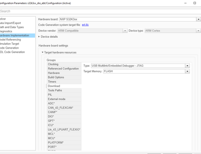

1. Example s32k3xx_dio_ebt:
         In this example, I choose the S32K344EVB-Q172 electronic board:
          Select the way to download the card as well

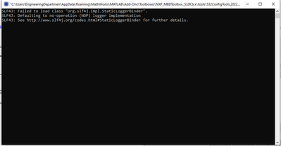

       If I try to enter the configuration of a block I get the following message:
        And if I try to flash the ECU, this is the diagnostic output -> s32k3xx_dio_ebt_Diagnostic.
2. Example s32k3xx_dio_s32ct:
And if I try to flash the ECU, this is the diagnostic output -> s32k3xx_dio_s32ct_Diagnostic.
I am setting the default jumpers on the electronic board, do I have to change them?

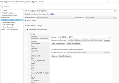

Hi, @josejulianEEVAM ,
Runtime error 216 is usually prompted when the target of your application is not the same as the hardware target, so please check that you have selected the right Hardware Part (S32K344-Q172 in your case) in the model settings. The embedded OPENSDA debugger of the board that you are using should work just fine.
Please check the following thread: S32K3X4EVB-T172, where you can find an extended answer to your problem.
