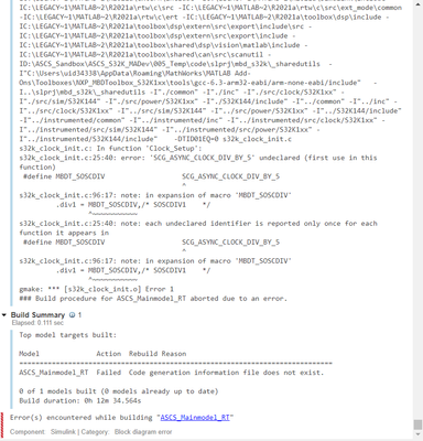

This is Hector here, customer is seeing a problem when upgrading to version 4.2.3 and I would like to know whether somebody has expereinced something similar. Below description, thanks.
I have problem after installing  (MBDT for S32K1xx Series Version : 4.2.3 (R2016a-R2020a)), before I was using Version 4.2.2. But after upgrading to 4.2.3, The following problem appears to me while generating a code.
I compared with Björn, but he don’t have this issue. I suppose, that something went wrong after upgrading to Version: 4.2.3
Could you please support?

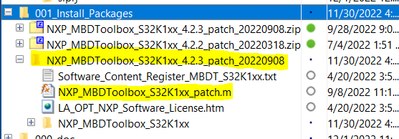

Just for info, this is the MBDToolbox patch that I used to install the package.

The problem described by the customer can be solved by updating to the toolbox to version 4.3.0.
The issue was resolved in internal task number AST-3351.
