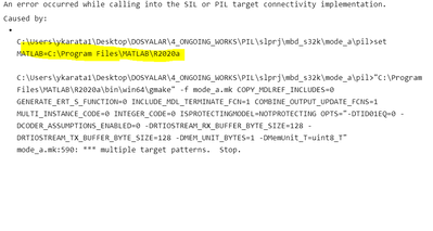

ykarata1
Dear All,
With our IT team, we have changed the directory that Matlab has located and our PIL has worked succesfully. I want to thank all of the contributors because I would not suspect from directory and this problem would take days from me. But I think NXP and MATLAB should handle that problem.
Thanks again.

SorinIBancila
I have to add that you need to remove the spaces from the Add-ons installation path too (you can see it in Preferences -> Matlab -> Add-ons).

paulvlase
Hi [email protected]‌,
This is a known issue caused by how Matlab R2019b generates the makefile used to build the application.
The workaround is to install the Matlab to a path that doesn't contain spaces in it. Move Matlab from C:\Program Files\MATLAB\R2019b to C:\MATLAB\R2019b.
You can copy/paste the MATLAB folder instead of installing Matlab again.
Paul

ykarata1
Dear All,
I guess I am facing with same issue. I think I could not be able to find the solution if I would not run into this community thread. Thanks for all contributors. Tomorrow, I will demand directory change of Matlab from IT deparment. According to result, I will write here.
