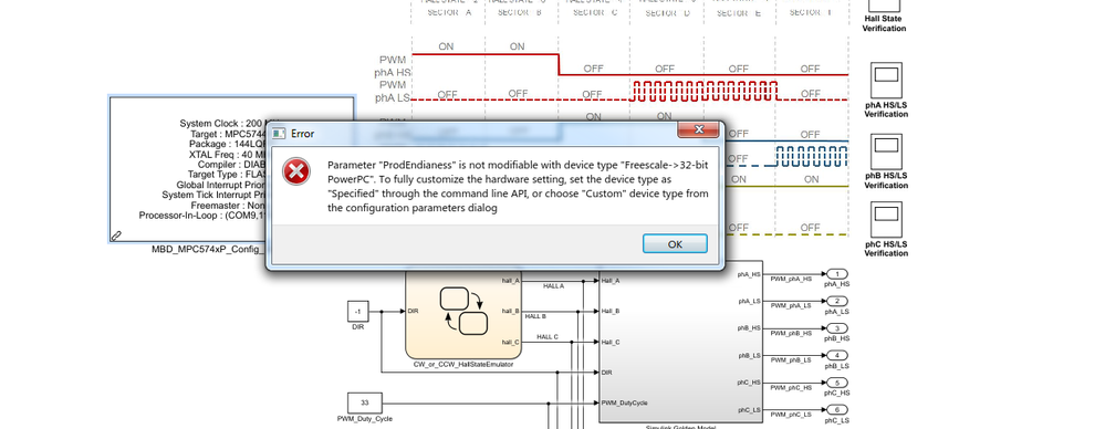

I am trying to run one of motor control toolbox example code on MPC5744P but when ever i hit the play button I get the following error.
No method 'getComponentBuildInfoPath' with matching signature found for class 'pntpil.MakefileBuilder'.
can you please tell me what is the issue here.

Thanks for the hotfix paulvlase. I was also facing the same "ProdEndianess" error as Ali and Sundar.
Also FYI, I also ran into the same error using the MPC5643L MBD Toolbox. I am running 2016b.

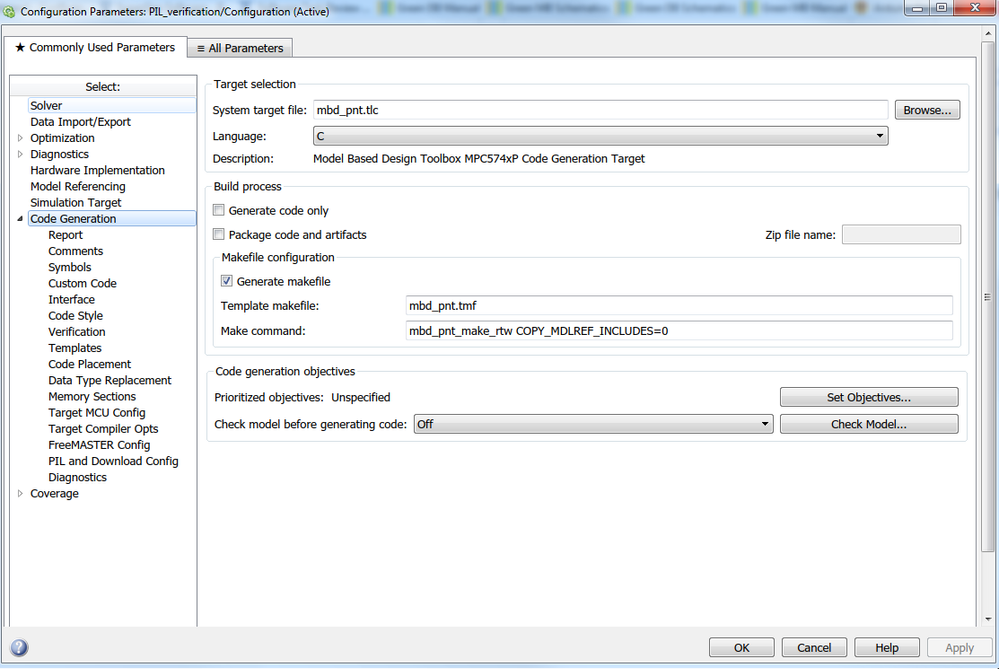

paulvlase
Can you post screenshots with "Code Generation" and "Hardware Implementation" (with "Device Details" expanded) sections from Configuration Parameters?
2,362 Views
alimeraj
Matlab 2017a config settings

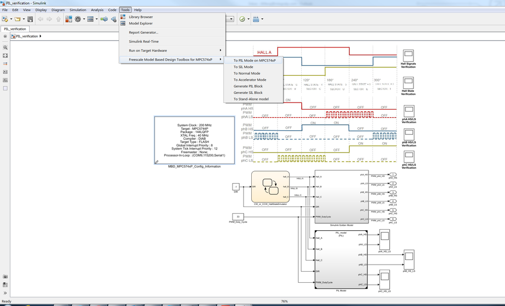

alimeraj
Hi Paul,
I extracted lecture 7 files again and tried to run the model as following:
and it throws the error straight away:
Ali
