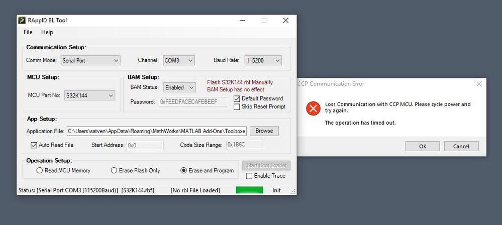

satvenmechatron
Hi Marius Lucian Andrei,
Thanks for your replay. We have tried with the .rbp file with RAppID s/w but we are facing the following the issue please find the attachment.
please help us to resolve this issue.

Daniel_Popa
In order to use the RappID Bootloader you need to perform 2 steps:
#1: Flash with S32 Design Studion the Flash Algorithm (the RBF file) into the S32K144 Flash Memory over JTAG interface. The RBF file can be found in the src\tools\BootLoader\RBF_Files folder
For more information please check this: https://community.nxp.com/thread/455356#comment-925112
#2: The application that is supposed to be loaded via RappID bootloader application must be compiled with Bootloaded support from Simulink (select UART as download interface). There are Simulink Examples for this topics.

mariuslucianand
Hi satvenmechatronics‌,
If you have already downloaded and installed the MBDT Software you can easily find the rbf RappId Bootloader for S32K144 in the {Matlab AddOns Directory}\S32K\Toolboxes\NXP_MBDToolbox_S32K1xx\code\tools\BootLoader\RBF_Files. The .rbf file can be flashed on the board using the S32Design Studio for Arm.
Our Model-Base Design Toolbox provides automatically generated code deployment on target via Serial (using the bootloader above) or by using the OpenSDA on the EVB. Have you encountered any issues when flashing the board?
