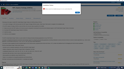

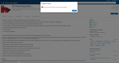

Hi, Recently I was installing S32K3 MATLAB toolbox , at first there is pop up with Installation failure  when I click on Add as "Community authored toolbox are temporarily unavailable" and then tried with downloading .mtblx file in MATLAB file exchange
Next downloaded file from NXP website  but again during installation of.mtblx file as Add on , there is pop up as"Toolbox cannot be installed because it is not a valid toolbox"            please help me in installing this

Hello @Mahesh12
If the MathWorks Add-Ons installation is not working as expected, please note that there is also another way in which you can install MBDT toolboxes.
Can you please follow the steps described in this thread (link), with the only change that the MBDT for S32K3 will be the toolbox that you will need to access?
MBDT for S32K3 v1.5.0 (the latest available) can be found at the following location: link: https://nxp.flexnetoperations.com/control/frse/download?element=3983098
Please let us know if this installation method works on your setup or if further guidance is required from our side.
