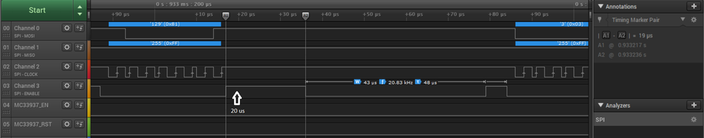

Setting deadtime for mc33937 ,
1) Send 0x81
2) 20 us CS High
3) 12 us CS Low
4) Send 0x03
Third step didn't works as i expected. I configured the 12 us, but it works aprroximatelly 43 us.

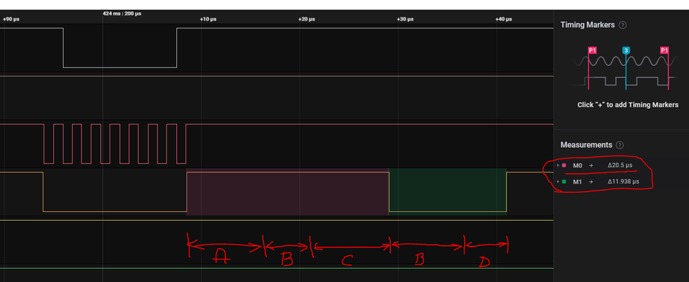

Below there are the suggestions I have for your approach in order to achieve the desired timing, as you may see in the screenshot below.

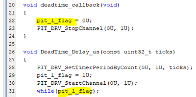

From the beginning, I shall tell that the PIT channel 0 is used to drive the main step interrupt, while the PIT channel 3 is used to calculate the timeout for the communications. So, instead of using 2 PIT channels, you could use only 1, and before waiting for the time to pass, you could set the period to wait for. But, the problem is that setting the new waiting value adds overtime, which of course can be calculated and can be considered constant.  The SDK provides 2 functions PIT_DRV_SetTimerPeriodByUs and PIT_DRV_SetTimerPeriodByCount which lets you update the new PIT counter. The difference between them is that the first one accepts units of microseconds and computes the ticks based on clock frequency for PIT, while the second one just takes the ticks parameter and updates the PIT register. Because you want to wait for such a tiny amount of time, I suggest using the second one, because the clock frequency for the PIT is 100Mhz, so it's easy to compute ticks when writing the code and not let the MCU to compute it every step execution.
I have modified the DeadTime_Delay_us to just receive the ticks as parameters, set the timer period, star the timer, and wait until the timer expires, using a flag variable, which is reset in the deadtime_callback.

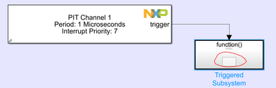

To link the deadtime_callback to the PIT1 in Simulink, I've been using a custom code example inserted in the PIT Channel 1 triggered Subsystem.
Now, the problem is the overhead execution for exiting the SPI transfer function, and the time passing from the moment when the DeadTime_Delay_us is called (setting the ticks value in registers) what you can see in my screenshot, segmented with A B C and D. Once you do the math, to reach 20us @ 100Mhz, you need to wait actually 2000  PIT ticks. But I've ended up calling the DeadTime_Delay_us with 399 ticks instead of 2000 because of what was mentioned above: the overhead of exiting the SPI transfer block function time A (this may vary on your side depending on how you call the SPI transfer) and the calling of DeadTime_Delay_us setting the ticks as well which takes around 5us time B, which can be seen on both delays. So it only remains to compute the C and D which in my case were 399 and 699. Of course, "A" may vary on your side.
I have attached the model and the code I've tested with, using the PTC29 SCK and PTD1 as PCS1. Please give it a try on your end, and let me know if you have further questions. Unfortunately, I cannot explain why it takes 43us on your side for the PIT 2.

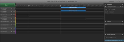

I configured your shared project (change SPI instance 1 , select Chip Select 3,changed SPI pins,change baud rate to 300000 kbps )
I compile and uplaod project,
When SPI configured as blocking mode , i saw this from logic analzer , message couldn't decoded from logic analzer whatever i make, and i couldn't see proper CS pin values
When i change SPI blocks to non-blocking mode , i just saw 0x81 data.

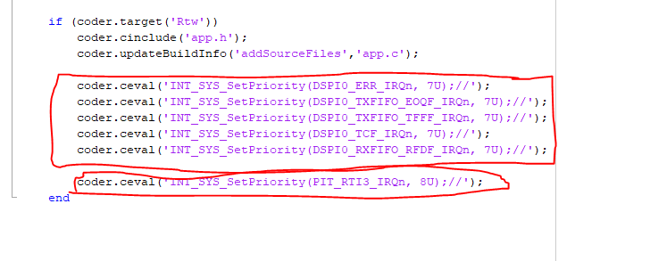

I am trying to provide you with a very fast response to make sure that you get the chance to test it today. My guess is that what you see might be related to the interrupts priorities of the SPI instance you are using. You can try to embed something similar as in the initialization custom code of the model I have attached.
Even if you are using the interrupts or blocking mode of the SPI transfer, behind, the SDK uses interrupts either if we talk about blocking or no blocking, so you will have to increase the priorities for the interrupts of the SPI instance you are using. I've used value 7 but has to be greater than the one of the PIT 0 interrupt (step time interrupt set in the config block), which drives the step trigger. Also, the PIT3 is used for the timeout of the blocking modes, so it has to be higher than the interrupts of the SPI.

Hello @mariuslucianand  i flash your.elf and connect pins with logic analzer . I verified that CS pin works as i want. But i couldn't see decoded messages due to logic analzyer technical constraints.
i try to implement it my own project after 1 months (i'll send it from DM)
