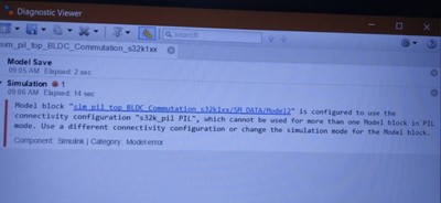

Hi, I'm trying to run multiple PIL in a single Simulink project but it looks like multiple model blocks in PIL mode can't be used, the next error occurs when I try to run the project.

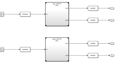

Simulink Model:

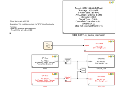

Both models are the gpio_s32k144 from the examples folder just with different names.
And I have two S32k144 connected to the computer through USB ports.
I want to know if it is possible or is there any other way to have two or more microcontrollers in a single simulation running independently.
