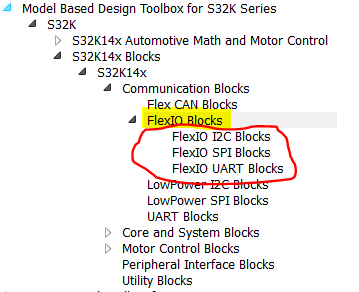

To correspond to Biss C or T-format of communication specification of ABS encoder
To make it possible by custom code, which peripheral should I use with it?
Do you have references or documents that will be helpful when creating the custom code
I think that ABS encoder is necessary for robot and linear guide.
Next to sensorless, I think that you want encoder control plus.
Thank you
2,983 Views
Daniel_Popa
Hi hayaoki7‌,
The S32K microprocessor has a dedicated peripheral that can be used to implement any kind of protocol. The peripheral is called FlexIO.
The FlexIO is a highly configurable module providing a wide range of functionality including:
  • Emulation of a variety of serial communication protocols
  • Flexible 16-bit timers with support for a variety of trigger, reset, enable and disable conditions
For documentation you can check the https://www.nxp.com/docs/en/reference-manual/S32K-RM.pdf  chapter 51
The NXP Model Based Design Toolbox for S32K1xx implements I2C/SPI and UART protocols over FlexIO by calling dedicated drivers from SDK.
In your case, since your encoder support a slightly different communication protocol you will have to configure the FlexIO peripheral in a slightly different manner.
For that you will need too implement standard Simulink S-Function Builder block or to use the Simulink Coder to call your custom code. You can check this as a starting point: https://community.nxp.com/thread/449904#comment-901737  on how to call your own C-code from Simulink models.
In general for custom code you should consult the MATLAB documentation since it is a standard feature.
Hope this helps!
