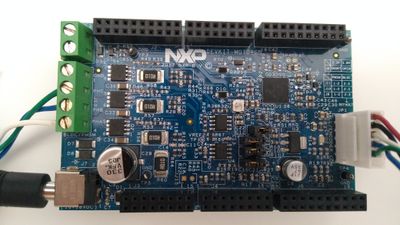

@haoxue1027 Hi Hao,
Please see my jumpers setup and if you want to try it (this one it's working with default pins and SPI0). I want to mention that this setup it's working for me but you have to remove 2 resistors from DEVKIT-MOTORGD : R70 and R73. The reason to remove those two resistors is that the output impedance of the level shifter it affect the signal if at the output is connected a pullup or pulldown resistor lower than 50kohm.
Your PWM output it's normal.
Adrian

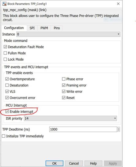

Hi @haoxue1027  ,
Unfortunately, I don't have Rev. E at this moment, but, I will try to help you.
First thing if you don't use the TPP interrupt, please disable it (uncheck the red box).
Then check jumpers: J28, J22, J31 must be set according to your setup (1-2 for 3.3V or 2-3 for 5V),
J29 - off, J23 - off. And be sure that you power the DEVKIT_MOTORGD using J7 connector placed on MOTORGD.
Please let me know if that helps.
Adrian

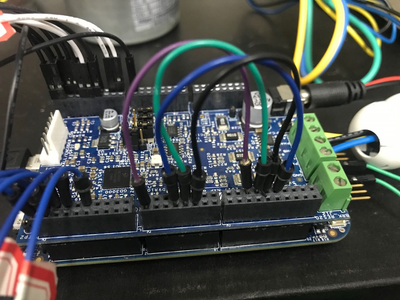

adriantudor
Hi @haoxue1027 ,
After analyzing with an oscilloscope I found that the SPI signals, and CS signal set in the TPP config block, they do not have the right shape (waveform) after the level shifter placed on the MPC board. I'm not sure about the cause but here is what you can do.
First, you must disable the outputs of the level shifter IC connected to SPI input signals of GD3000. By disabling its outputs we can then connect other SPI pins with wire jumpers to the same SPI inputs of GD3000.
So, to disable the outputs of this level shifter IC (U104) (placed on MPC5744P EVB) you must connect jumper J23. Now we must reroute other SPI signals to the same GD3000 inputs. I chose SPI 1 instance with pins: PA6 - SCK, PA7 - SOUT, and PA8 - SIN. Then I connected these pins with wire-jumpers to LT_PC5, LT_PC6, and LT_PC6. By disabling outputs of U104 we have disconnected the CS pin too, so I chose PTA3 to connect to LT_PE15.
I have updated your test1 project with what I told you here.
Adrian

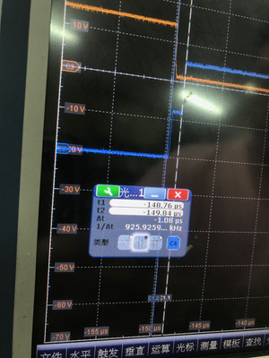

@adriantudor Hello,adrian
I found there was a slight error in your proposed PIN connection(the location of PC5,6,7.).
So I have tested again like following.
Fortunately, it worked as deadtime config(1000ns)!~~~A power cycle does not seem neccessary.
But there is a step in the PWM signal like following.
I want to confirm again, Is this normal ?
Thank you very much.
best regards
hao

adriantudor
@haoxue1027 Hi Hao,
Adrian
