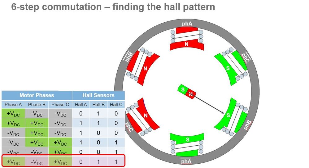

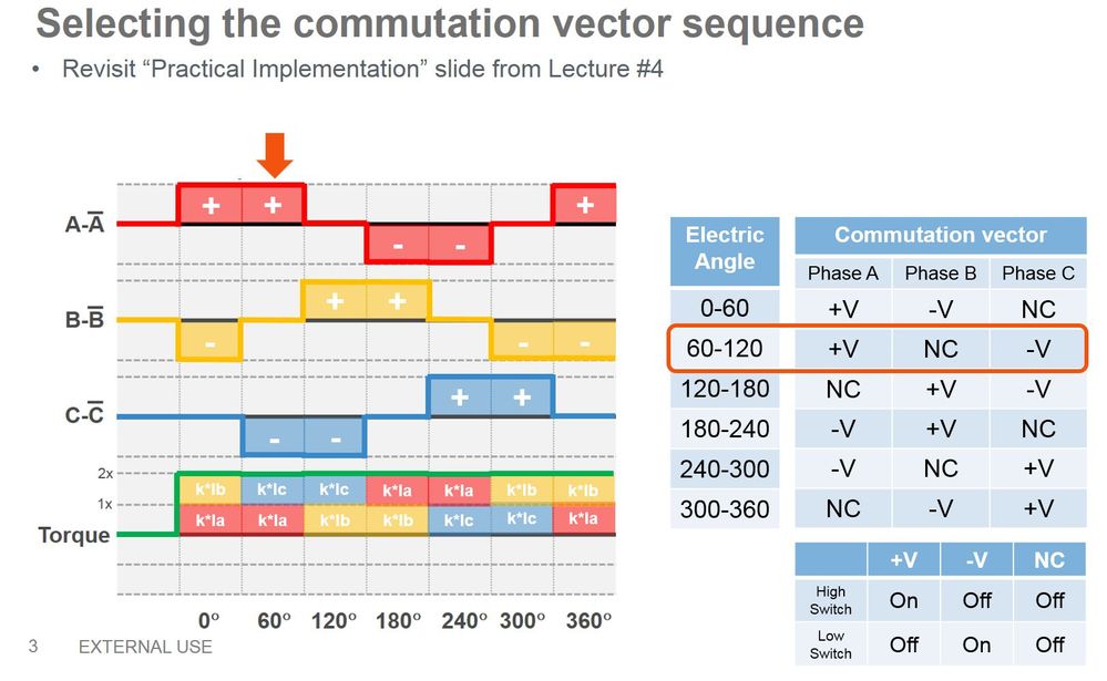

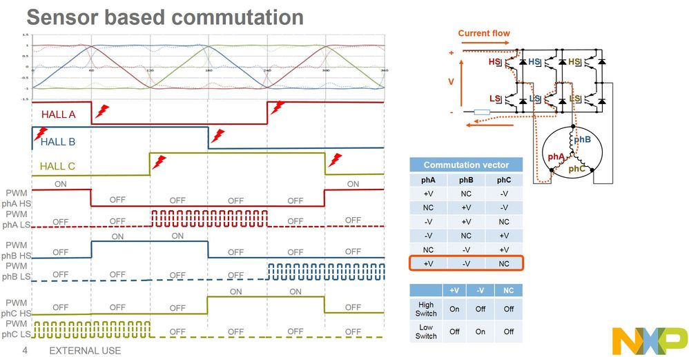

In this sixth lecture of the motor control course we discuss about how motor phase commutation works and how can we build a commutation table to ease the software processing to compute the PWM sequence that controls the power inverter which turn the rotor.
Main topics:
    - How the rotor turns when voltage is applied;
    - How to define the commutation table;
    - How to control the power inverter switches;
    - How to identify the commutation sequence;

I have tried a few  different orders of Phase A/B/C and Hall 1/2/3. The result communication table had different pattern as yours; is that all right?
If it's true, what's the main reason to cause the pattern difference?
Jd
13,744 Views
Daniel_Popa
Hi jimduanva‌,
It's true! So this is a very important step in making the BLDC motor working. In fact over last weekend i had to redue the procured for a another motor in order to make it run.
Initially, i thought to save some time and started to play with the CW and CCW tables manually hoping to find a quick setup to work. I managed to spin the motor but very oddly. At some point i've decided to repeat the procedure shown in this lecture and in less than 1h i had the motor running correctly and honestly the commutation tables were totally different than what i was trying to guess.
Here is a good application node that describes in details this procedure.
https://www.nxp.com/docs/en/application-note/AN4413.pdf
Hope this helps!
