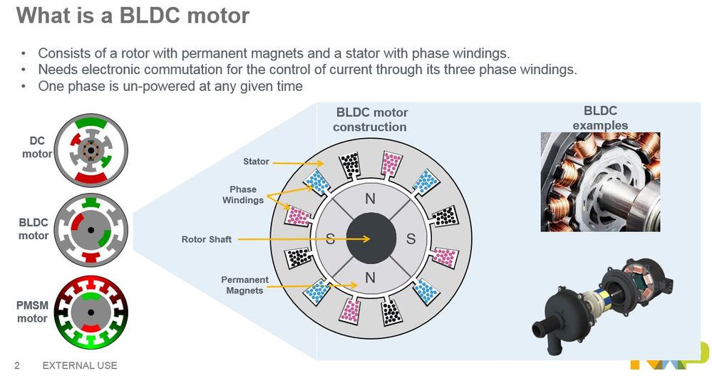

In this 4th lecture of the motor control course we want to understand better the theory behind the BLDC motors.
Main topics:
    - Motor classification and how they operate;

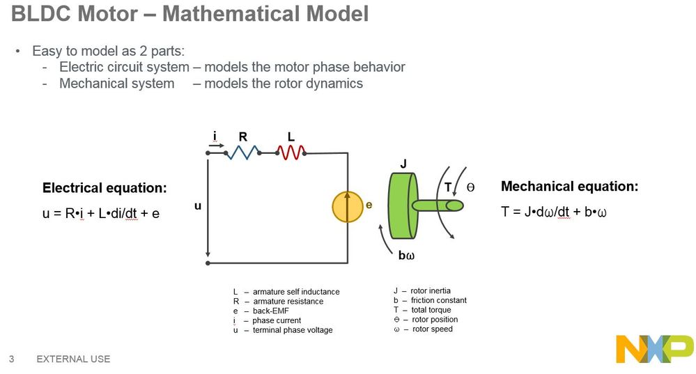

    - BLDC motor electro-mechanical modelling;

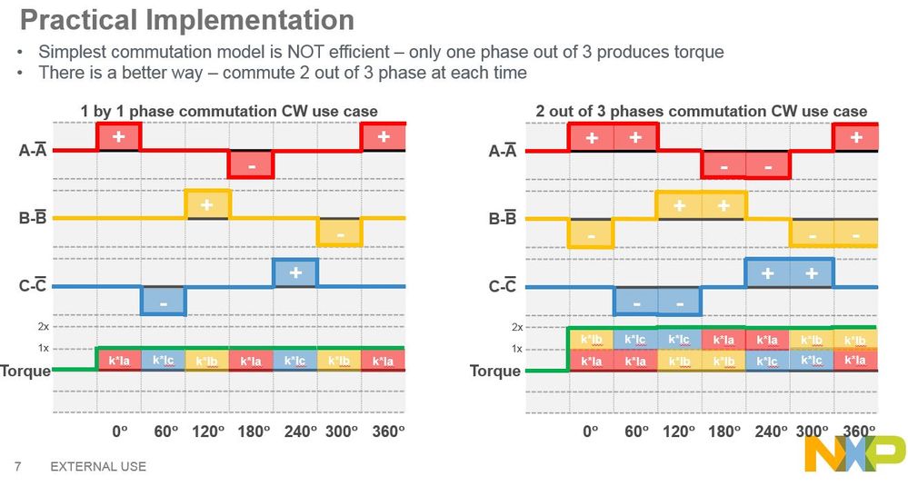

    - BLDC motor - commutation aspects;
    - BLDC vs PMSM comparison;
Objectives:
    - Understand BLDC motor operation;
    - Understand BLDC commutation;
