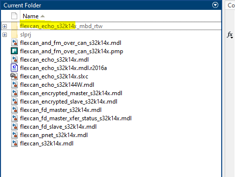

Hello there!
I am working with a S32k board and I want to monitor the number of CAN messages I am receiving at the input of my communication system. It doesn't matter if it only gives me the number of messages or the ID of the CAN messages I am receiving. How can I do this? I was trying to implement a counter but no success. Any ideas ?
Also, I would like to know how to do it from the S32DS, I am guessing it can be done from there.
Besides that, I am having trouble finding the project for importing it into the DS, I am not finding it anywhere so I asumme I am not exporting it correctly.. which is the extension it is supposed to have?
Thanks in advance!

mariuslucianand
Hello [email protected]‌,
Do you receive any of the messages over CAN?
For the importing issue, the model generates in the Matlabs current directory,  a folder with the same name as the model, ended in _mbd_rtw. In that folder, you should be able to find the ProjectInfo.xml file that helps you importing the generated code in the S32DS code.
Hope this helps,
Marius

juliana_rojas30
Hi @mariuslucianand,
Thank you very much for your reply. Yes, I do receive CAN. Let me explain, I am receiving a lot of CAN messages at a high speed. So the problem is that when I echo them back, there are a lot of lost messages. Now, I don't know why, and that's what I am trying to figure out. First I am trying to be sure that the messages arrive to the board, so that's why I am trying to make  a counter. I guess it's easier to get this data from the Design Studio, but I am having issues with it.
Regarding the S32DS, yes, that worked. Now when I try to build the code I get this:
Any idea what can that be about?
Thanks!
