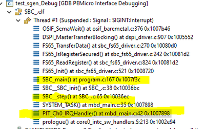

I am working on a project to convert the SBC driver that comes with S32 IDE for the MPC5744p board.
I have created a Matlab function at the Simulink model that acts as a function wrapper that calls a main() function of the SBC driver of the demo example that comes with S32 IDE.
However, it appears that SBC initialization stick in the code portion in the osif_baremetal.c
while (*pSem == 0u)
uint32_t crt_ticks = osif_GetCurrentTickCount();
uint32_t delta = crt_ticks - start;
if ((timeoutTicks != OSIF_WAIT_FOREVER) && (delta > max))
/* Timeout occured, stop waiting and return fail code */
osif_ret_code = STATUS_TIMEOUT;
break;

The problem you are facing is caused by the generated code architecture. Basically, the code that you have inserted is executed inside an interrupt. This is a method used by the MBDT in order to ensure the step time (I will explain below). Problem is that the Osif waits for the osif_tick_cnt variable to be incremented in the osif_Tick() handler. We are using the MPC, so the SDK uses the PIT_Channel 3 in order to run the osif_Tick() handler that will increment the osif_tick_cnt variable. But because the program you have inserted is called from inside an interrupt particularly the PIT_Channel0, and the PITChannel3 Interrupt has no priority set by the SDK, the MCU will not preempt the PITChannel0 in order to trigger the Channel 3 and to increment that variable.
The easiest fix for your program to work is to use the following code before executing your custom code.
/* Set priority for PIT Channel 3 ISR */
INT_SYS_SetPriority(PIT_Ch3_IRQn, 8U);
This line will set a higher interrupt for the PIT Channel 3, used by the Osif and will preempt the PIT Channel 0 to increment the value.

But the problem with your application is that from inside an interrupt, the code will end up running an entire another application. It will perform again the clocks initialization, while loops, and so on. What you should do is to reuse as much as possible the code generated by the MBDT for example the SPI initialization, and from the custom code, you should call the API from inside the SBC driver. You have here such example https://community.nxp.com/t5/NXP-Model-Based-Design-Tools/How-to-use-your-own-C-code-in-our-Toolbox-... where the program uses the BCC driver to communicate with another chip by inserting the driver functions using custom code. Another example that worth having a look on it, can found here https://community.nxp.com/t5/NXP-Model-Based-Design-Tools/MPC5744P-and-MC33771-Configuration/m-p/107...
