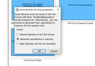

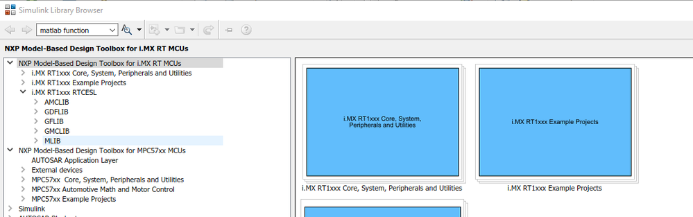

I followed the quick start guide step by step, everything seems OK during the installation. I'm using Matlab R2021a.
But finally the MPC57xx MBDtoolbox does not appear in Simulink Library Browser. However I can run  MPC57xx MBD examples successfully on devkit.
For a simple comparison, MBDtoolbox for IMXRT does not have the same problem.

mariuslucianand
Hello @Bing,
Please open the Simulink Library and press the F5 button. Then select the second option and see if the MPC57xx Toolbox appears.

13,789 次查看
Bing
Hi Marius,
I've tried refreshing Simulink Library Browser, but I'm not quite clear with “select the second option” and can not find the entry.
Thanks for helping,
Bing

mariuslucianand
Hello @Bing ,

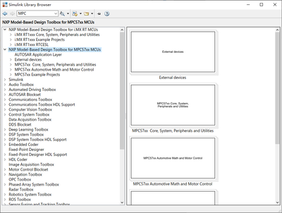

The second option I was telling you about is the "Generate repositories in memory" as show below, when you press the F5 button.
Once I did that, I can see both libraries in my Simulink Library Browser.
Hope this helps,
Marius

Bing
Hi @mariuslucianand
It works! Great help!
Thanks for guiding,
