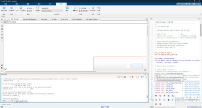

FernandoQian
Hi Marius,
Thank you for your response. As I followed the steps, I encountered an error with the Simulink project compilation. It seems that the MC33771C driver files are missing necessary headers, which are included in the MBDT tool files. Shall I attach these headers from MBDT tool files to the bcc directory of MC33771C driver?
