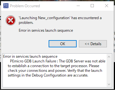

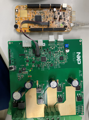

hayaoki7
Hello Marius,
Jumper J107 removal, 'S32K142EVB: J14 === MCSXTE2BK142: J4'  are connected. I started Flash Configurations using S32DS_ARM2.2. The connection is as shown in the photo. An error was displayed. Am I doing something wrong? please tell me.
Best regards.,
hayaoki7

mariuslucianand
Hello @hayaoki7 ,
My guess is that the green board, the MCSXTE2BK142 is not powered up the S32K142 has to be powered up because it will be not powered over the JTAG cable.
But if you do so, basically the  you will also power up the controller on the S32K142 board and we don't; want that. So, there are two more steps that have to be made:
1. take off the jumpers from the J10 as well.
2. Unsolder the R117. This way the VDD that comes on the SWD J14 will not end up to the MCU from the board as well.. IN the future, if you solder the J15 you will be able to use again the MCU on the board.

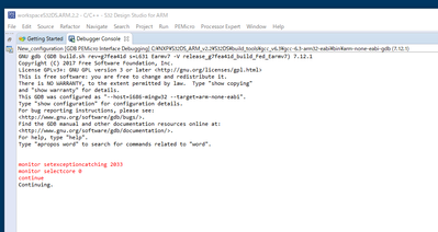

hayaoki7
Hello Marius,
I removed J10. R117 is not removed. The two boards S32K142EVB: USB, MCSXTE2BK142: DC24V.
I turned on the power to the two boards. I did Flash. After that, the Debugger Console is displayed and nothing goes from Continuing. Is the RBL file written? please tell me.

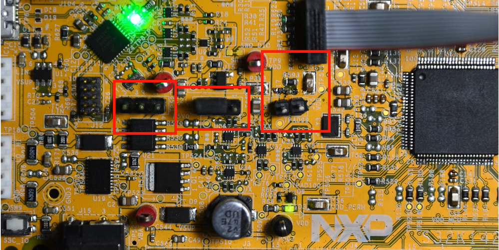

mariuslucianand
Hello @hayaoki7 ,
I've tried to replicate your setup. I don't have the MCSXTE2BK142 so I've used another evaluation board. So let me describe the steps:
1. You have to desolder the R117 from the board. The R117 is a 0Ohm resistor and it is mounted in parallel with the J15. Over this 0Ohm resistor, the MCU is powered up so you have to make sure the MCU on the evaluation board is turned off. In the future, you solder a 2x1 header to the J15, and using a jumper you can use back the MCU on the board.
2. The J10 has to be connected in 2-3. The J10 selects the VDD that comes over the Jtag cable from the MCSXTE2BK142. It routes the VDD to the level shifters used by the OpenSDA.
3. The J107 has to be unconnected.
Using this setup I was able to program the second MCU successfully. With this setup (EVB connected over JTAG cable), you can use the OpenSDA from the EVB as if it were mounted on the MCSXTE2BK142 so you can even program the board directly from Simulink as if you were programming the EVB board.
If you flash the RBF file using S32DS, you can then disconnect the JTAG cable and program the board over Serial using RappId bootloader. This is the test that the flashing was successfull.
