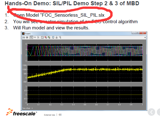

zhuaoci
The following figure showsBut I can't find the Simulink model below.QQ截图20171024200736.pngQQ截图20171024200811.png
