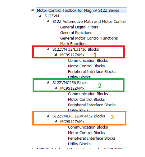

From what I understand, the MBDT is compatible with the family of S12ZVMB MCUs.
I want to design an application using evaluation board S12ZVMBEVB (refer to the following link)
S12ZVMB Evaluation Board|NXP
Could you please tell me where I can find examples (motor control or others).
For S12ZVMB Evaluation Board|NXP which library sould i use ? (refer please to the following) 1 or 2 or 3
Thanks in advance for your support

In the NXP web page dedicated to the MBDT https://www.nxp.com/support/developer-resources/run-time-software/automotive-software-and-tools/mode...
It is indicated that the toolbox support the S2ZVMB (refer to the following)
There is a contradiction, right?

constantinrazva
Hello [email protected]‌,
S12 Toolbox supports the following parts (as stated in the release notes)
So the toolbox does not support S12ZVMB unfortunately (not tested on). I do not know what are the differences between them. If they are very similar, the toolbox could be ported.

Can the toolbox support s12zvmb? I can see that s12zvmb is still available on the product web page
4,314 Views
adriantudor
Hello @SUT ,
The answer given by Razvan is still up to date. Anyway, the S12ZVMBEVB development board was designed to drive DC two-phase motor using H-bridge, while the MBDT for S12ZVM has only BLDC/PMSM examples.
