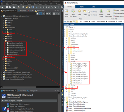

I take the SDK-Example in MCUXpresso "evkmimxrt1060_dev_cdc_vcom_bm" and copy the files into my Matlab Config folder:

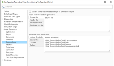

I define the directories as:
And the source files as:
(I also tried:

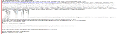

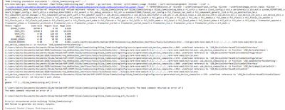

But the model builds with errors:
How best to resolve?

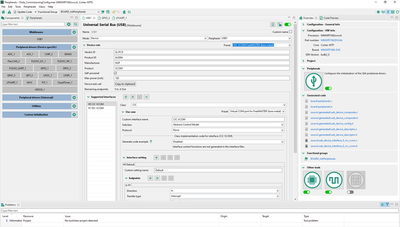

I also found capabilities in MCUConfig:
But it generates the same errors:

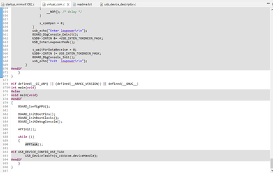

Hello @Sam_ECU,
The reason why you have the error regarding the definition of main function twice is because of the virtual_com.c file from the evkmimxrt1060_dev_cdc_vcom_bm MCUXpresso example. That file contains the main function for that particular application and there will a conflict with the main function defined in the Simulink generated code from ert_main.c file.
Try not to add those source files virtual_com.c and virtual_com.h in Simulink project.
