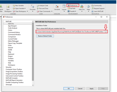

stefancinipeanu
Hi, @henryex2009
The problem is the space character in MATLAB Add-Ons in toolbox installation path:
C:\Users\Administrator\AppData\Roaming\MathWorks\MATLAB Add-Ons\Toolboxes\NXP_MBDToolbox_MPC57xx
To fix it, you can try the following approach:
  1. Close MATLAB
  2. Rename the path in C:\Users\Administrator\AppData\Roaming\MathWorks\MATLAB-Add-Ons\Toolboxes\NXP_MBDToolbox_MPC57xx    Notice the change from MATLAB Add-Ons to MATLAB-Add-Ons
  3. Open MATLAB and go to Preferences button.
  4. Change the MATLAB Add-Ons folder to the new renamed path: C:\Users\Administrator\AppData\Roaming\MathWorks\MATLAB-Add-Ons\Toolboxes\NXP_MBDToolbox_MPC57xx
       5.Restart MATLAB
Let me know if this worked.
Stefan.
7,242 Views
henryex2009
Hi, Stefan,
Yes, the PIL model is running successfully, Thank you for your help.
Henry
