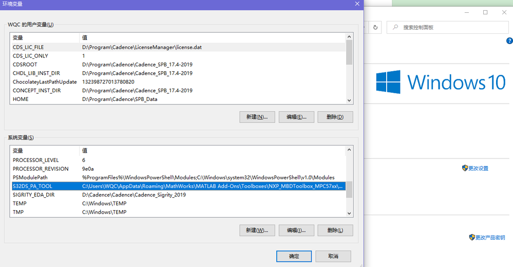

Is the environment variable set in windows or matlab?
Is it in this position?
After setting, I always report errors when loading the model to the board:

### Build procedure for uart_hello_world_mpc574xP aborted due to an error.
Error:
C:\Users\WQC\AppData\Roaming\MathWorks\MATLAB Add-Ons\Toolboxes\NXP_MBDToolbox_MPC57xx\uart_hello_world_mpc574xP_mbd_rtw>set MATLAB=D:\Program\Polyspace\R2020a
C:\Users\WQC\AppData\Roaming\MathWorks\MATLAB Add-Ons\Toolboxes\NXP_MBDToolbox_MPC57xx\uart_hello_world_mpc574xP_mbd_rtw>"D:\Program\Polyspace\R2020a\bin\win64\gmake" -f uart_hello_world_mpc574xP.mk GENERATE_ERT_S_FUNCTION=0 INCLUDE_MDL_TERMINATE_FCN=1 COMBINE_OUTPUT_UPDATE_FCNS=1 MULTI_INSTANCE_CODE=0 INTEGER_CODE=0 ISPROTECTINGMODEL=NOTPROTECTING OPTS="-DTID01EQ=0"
Cleaning...
RELATIVE_PATH_TO_ANCHOR is ..
==== Removing object files from build directory ====
Copying necessary files to build directory...
Compiler details : "C:\Users\WQC\AppData\Roaming\MathWorks\MATLAB Add-Ons\Toolboxes\NXP_MBDToolbox_MPC57xx\tools/S32DS/build_tools/powerpc-eabivle-4_9/bin/powerpc-eabivle-gcc" -DCPU_MPC5744P -mcpu=e200z4 -DSTART_FROM_FLASH --sysroot="C:\Users\WQC\AppData\Roaming\MathWorks\MATLAB Add-Ons\Toolboxes\NXP_MBDToolbox_MPC57xx\tools/S32DS/build_tools/e200_ewl2" -g3 -mbig -mvle -O1 -mregnames -mlsp -specs=ewl_c9x.specs -mhard-float -Wall -c -std=c99 -fdata-sections -ffunction-sections -funsigned-char -fmessage-length=0 -nostdinc -fno-jump-tables -DTURN_ON_CPU0 -mlsp -DTURN_ON_CPU0 -I. -I.. -I.. -I"D:\Program\Polyspace\R2020a\simulink\include" -I"D:\Program\Polyspace\R2020a\extern\include" -I"D:\Program\Polyspace\R2020a\rtw\c\src" -I"D:\Program\Polyspace\R2020a\rtw\c\libsrc" -I"D:\Program\Polyspace\R2020a\rtw\c\src\ext_mode\common" -I"D:\Program\Polyspace\R2020a\rtw\c\src\ext_mode\tcpip" -I"D:\Program\Polyspace\R2020a\rtw\c\src\ext_mode\serial" -I"D:\Program\Polyspace\R2020a\rtw\c\src\ext_mode\custom" -IC:\Users\WQC\AppData\Roaming\MATHWO~1\MATLAB Add-Ons\Toolboxes\NXP_MBDToolbox_MPC57xx -IC:\Users\WQC\AppData\Roaming\MATHWO~1\MATLAB Add-Ons\Toolboxes\NXP_MBDToolbox_MPC57xx\uart_hello_world_mpc574xP_mbd_rtw -ID:\Program\POLYSP~1\R2020a\extern\include -ID:\Program\POLYSP~1\R2020a\simulink\include -ID:\Program\POLYSP~1\R2020a\rtw\c\src -ID:\Program\POLYSP~1\R2020a\rtw\c\src\ext_mode\common -ID:\Program\POLYSP~1\R2020a\rtw\c\ert -I"C:\Users\WQC\AppData\Roaming\MathWorks\MATLAB Add-Ons\Toolboxes\NXP_MBDToolbox_MPC57xx\tools/S32DS/build_tools/e200_ewl2/EWL_C/include" -I"C:\Users\WQC\AppData\Roaming\MathWorks\MATLAB Add-Ons\Toolboxes\NXP_MBDToolbox_MPC57xx\tools/S32DS/build_tools/e200_ewl2/EWL_C/include/pa" -I"./common" -I"./inc" -I"./src/clock/MPC57xx" -I"./src/clock/MPC5777C" -I"./src/sim/MPC5744P" -I"./src/power/MPC57xx" -I"./src/pins/siul2" -I"./src/pins/siu" -I"./MPC5744P/include" -I"../common" -I"../inc" -I"../src/clock/MPC57xx" -I"../src/clock/MPC5777C" -I"../src/sim/MPC5744P" -I"../src/power/MPC57xx" -I"../src/pins/siul2" -I"../src/pins/siu" -I"../MPC5744P/include" -I"../instrumented/common" -I"../instrumented/inc" -I"../instrumented/src/clock/MPC57xx" -I"../instrumented/src/sim/MPC5744P" -I"../instrumented/src/power/MPC57xx" -I"../instrumented/src/pins/siul2" -I"../instrumented/MPC5744P/include" -DTID01EQ=0
Assembler details : "C:\Users\WQC\AppData\Roaming\MathWorks\MATLAB Add-Ons\Toolboxes\NXP_MBDToolbox_MPC57xx\tools/S32DS/build_tools/powerpc-eabivle-4_9/bin/powerpc-eabivle-gcc" -c -g3 -mbig -mvle -mregnames -O1 -DTURN_ON_CPU0 -mhard-float -mlsp -DTURN_ON_CPU0
Product: uart_hello_world_mpc574xP.mot
Build product type: executable
Building file core0_intc_sw_handlers.o...
"C:\Users\WQC\AppData\Roaming\MathWorks\MATLAB Add-Ons\Toolboxes\NXP_MBDToolbox_MPC57xx\tools/S32DS/build_tools/powerpc-eabivle-4_9/bin/powerpc-eabivle-gcc" -c -g3 -mbig -mvle -mregnames -O1 -DTURN_ON_CPU0 -mhard-float -mlsp -DTURN_ON_CPU0 -I.. -o core0_intc_sw_handlers.o core0_intc_sw_handlers.S
Building file interrupt_vectors.o...
"C:\Users\WQC\AppData\Roaming\MathWorks\MATLAB Add-Ons\Toolboxes\NXP_MBDToolbox_MPC57xx\tools/S32DS/build_tools/powerpc-eabivle-4_9/bin/powerpc-eabivle-gcc" -c -g3 -mbig -mvle -mregnames -O1 -DTURN_ON_CPU0 -mhard-float -mlsp -DTURN_ON_CPU0 -I.. -o interrupt_vectors.o interrupt_vectors.S
Building file startup_MPC5744P.o...
"C:\Users\WQC\AppData\Roaming\MathWorks\MATLAB Add-Ons\Toolboxes\NXP_MBDToolbox_MPC57xx\tools/S32DS/build_tools/powerpc-eabivle-4_9/bin/powerpc-eabivle-gcc" -c -g3 -mbig -mvle -mregnames -O1 -DTURN_ON_CPU0 -mhard-float -mlsp -DTURN_ON_CPU0 -I.. -o startup_MPC5744P.o startup_MPC5744P.S
Building file clock_MPC57xx.o...
"C:\Users\WQC\AppData\Roaming\MathWorks\MATLAB Add-Ons\Toolboxes\NXP_MBDToolbox_MPC57xx\tools/S32DS/build_tools/powerpc-eabivle-4_9/bin/powerpc-eabivle-gcc" -DCPU_MPC5744P -mcpu=e200z4 -DSTART_FROM_FLASH --sysroot="C:\Users\WQC\AppData\Roaming\MathWorks\MATLAB Add-Ons\Toolboxes\NXP_MBDToolbox_MPC57xx\tools/S32DS/build_tools/e200_ewl2" -g3 -mbig -mvle -O1 -mregnames -mlsp -specs=ewl_c9x.specs -mhard-float -Wall -c -std=c99 -fdata-sections -ffunction-sections -funsigned-char -fmessage-length=0 -nostdinc -fno-jump-tables -DTURN_ON_CPU0 -mlsp -DTURN_ON_CPU0 -I. -I.. -I.. -I"D:\Program\Polyspace\R2020a\simulink\include" -I"D:\Program\Polyspace\R2020a\extern\include" -I"D:\Program\Polyspace\R2020a\rtw\c\src" -I"D:\Program\Polyspace\R2020a\rtw\c\libsrc" -I"D:\Program\Polyspace\R2020a\rtw\c\src\ext_mode\common" -I"D:\Program\Polyspace\R2020a\rtw\c\src\ext_mode\tcpip" -I"D:\Program\Polyspace\R2020a\rtw\c\src\ext_mode\serial" -I"D:\Program\Polyspace\R2020a\rtw\c\src\ext_mode\custom" -IC:\Users\WQC\AppData\Roaming\MATHWO~1\MATLAB Add-Ons\Toolboxes\NXP_MBDToolbox_MPC57xx -IC:\Users\WQC\AppData\Roaming\MATHWO~1\MATLAB Add-Ons\Toolboxes\NXP_MBDToolbox_MPC57xx\uart_hello_world_mpc574xP_mbd_rtw -ID:\Program\POLYSP~1\R2020a\extern\include -ID:\Program\POLYSP~1\R2020a\simulink\include -ID:\Program\POLYSP~1\R2020a\rtw\c\src -ID:\Program\POLYSP~1\R2020a\rtw\c\src\ext_mode\common -ID:\Program\POLYSP~1\R2020a\rtw\c\ert -I"C:\Users\WQC\AppData\Roaming\MathWorks\MATLAB Add-Ons\Toolboxes\NXP_MBDToolbox_MPC57xx\tools/S32DS/build_tools/e200_ewl2/EWL_C/include" -I"C:\Users\WQC\AppData\Roaming\MathWorks\MATLAB Add-Ons\Toolboxes\NXP_MBDToolbox_MPC57xx\tools/S32DS/build_tools/e200_ewl2/EWL_C/include/pa" -I"./common" -I"./inc" -I"./src/clock/MPC57xx" -I"./src/clock/MPC5777C" -I"./src/sim/MPC5744P" -I"./src/power/MPC57xx" -I"./src/pins/siul2" -I"./src/pins/siu" -I"./MPC5744P/include" -I"../common" -I"../inc" -I"../src/clock/MPC57xx" -I"../src/clock/MPC5777C" -I"../src/sim/MPC5744P" -I"../src/power/MPC57xx" -I"../src/pins/siul2" -I"../src/pins/siu" -I"../MPC5744P/include" -I"../instrumented/common" -I"../instrumented/inc" -I"../instrumented/src/clock/MPC57xx" -I"../instrumented/src/sim/MPC5744P" -I"../instrumented/src/power/MPC57xx" -I"../instrumented/src/pins/siul2" -I"../instrumented/MPC5744P/include" -DTID01EQ=0 -o clock_MPC57xx.o clock_MPC57xx.c
powerpc-eabivle-gcc: error: Add-Ons\Toolboxes\NXP_MBDToolbox_MPC57xx: No such file or directory
powerpc-eabivle-gcc: error: Add-Ons\Toolboxes\NXP_MBDToolbox_MPC57xx\uart_hello_world_mpc574xP_mbd_rtw: No such file or directory
gmake: *** [clock_MPC57xx.o] Error 1
Error(s) encountered while building "uart_hello_world_mpc574xP".
Does anyone know why?

The final solution: the problem of system environment variable configuration-the configuration is the S32DS installation directory, not the directory in the toolbox.

constantinrazva
Hello jasonhd ,
Can you let me know what version of the toolbox you are using? You can find it easily by looking into Add-on Manager from MATLAB or by running the following command:
ver
If you want to use the default compiler (gcc), it already comes shipped with our toolbox; if you don't have any environment variable defined, the toolbox will automatically set it up for you to the gcc we ship.
As for the variable, you can set it in windows or in MATLAB; but if you choose the 2nd option, you should set it every time you open MATLAB.
As for the error, can you attach the model you are building so we can test it on our end?
One more thing I want to mention is that it is recommended you install the toolbox in a path with no spaces.
