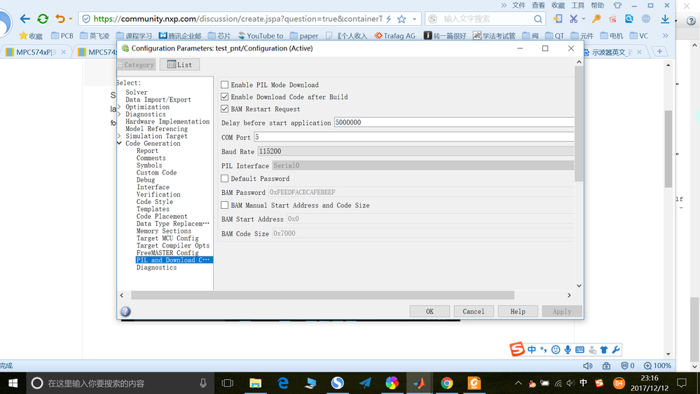

     I have a DEVKIT-MPC5744P Board and download  MBDToolboxMPC574xPReleaseV2.0.0. The matlab version is 2015b.
S32 version is S32DS_Power_Win32_v2017.R1_b171019.  I complie an example test_pnt.mdl. and test_pnt.elf is built at last. Then download this file to DEVKIT-MPC5744P through BAM. Then test the signal on the pin A0 A1 by oscilloscope. I found nothing. I don't know why.

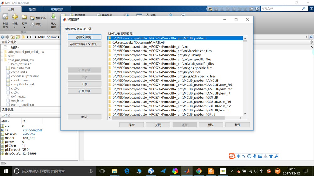

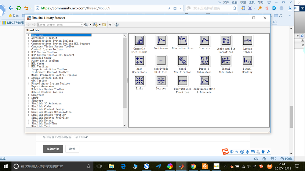

      I have anthor question. I can not see the mbd for 574xp in the simulink library browser. I have add the path.

Hi gaokai‌,
Most likely you need to apply this patch https://community.nxp.com/thread/451804#comment-916493
The toolbox was release before the S32DS version you are pointing and there are changes in the GCC Linker.
