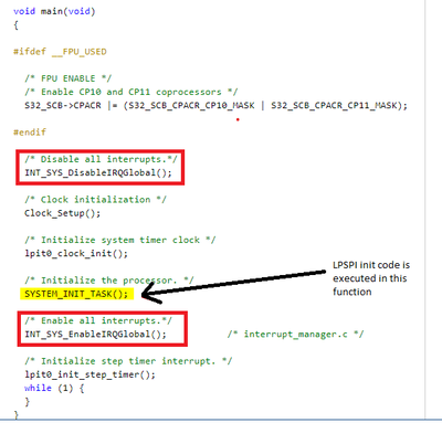

From the model deployed on target in normal mode, the entire LPSPI initialization code is executed before enabling all interrupts, as shown in the next image.

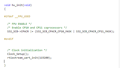

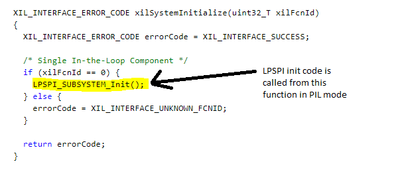

In PIL mode, the code is generated differently. The LPSPI init code is executed in the xilSystemInitialize function defined in the xil_interface.c which is generated automatically by Siumulink and we don`t have  control on this, so we cannot call the functions for enabling the interrupts. Also, the main function that we defined in normal mode in the mbd_main.c file is redesigned as hw_init in the mbd_hw_init.c file and we could enable the interrupts there, but we cannot call the initialization function which contains the LPSPI init code.
