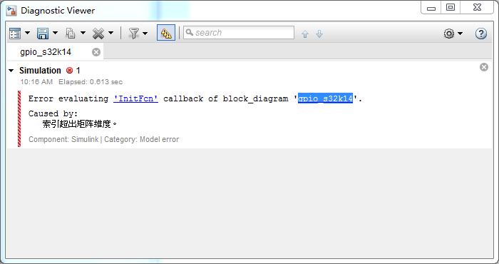

I reinstalled MBDTool V3.0 on my computer, also generate license.dat and put it into lic Folder, but when I run the example 'gpio_s32k14', there is something wrong like this:pastedImage_1.png
I don't know how it happens, and how can I solve this?
I have restored the default MATLAB path and it doesn't work.

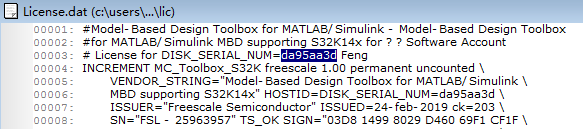

 Hi joshisr,
   I have reinstalled MBDTool many times ,but it always have the same error, But there are some thing confused me: how to uninstall the MBDTool correctly? I just deleted the folder where it installed, are there some offical uninstall tool or method for user? Or I just need to delete the folder and install MBDTool time and time again?

constantinrazva
Hello 李风heart ,

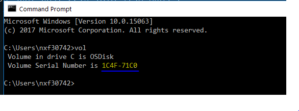

Can you open a command prompt on your computer and run the following command
vol
and tell us if the Volume Serial Number matches the one from the license file?
(this is from license.dat file)
Kind regards,
Razvan.
5,143 Views

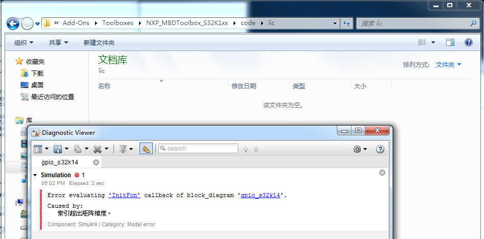

李风heart
Hi Razvan,
Thanks for your response.The Disk Serial Number is same to tle Number in lic file.
And there is another phenomenon, after I remove license.dat from lic file, the model has the same error information like thispastedImage_5.png

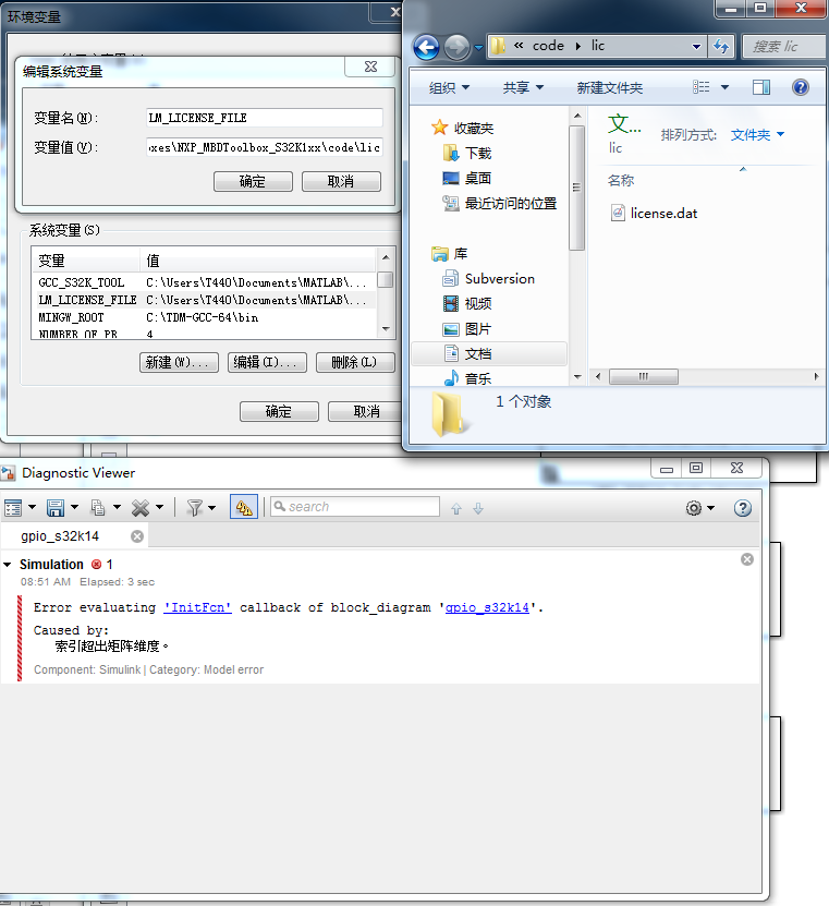

constantinrazva
Can you try for the moment the workaround proposed by hongjinzeng‌ ?
Here he says the licensing worked after setting the environmental variable LM_LICENSE_FILE to the path of his license.lic file.
Can you try this out ?
Kind regards,
Razvan.
5,143 Views

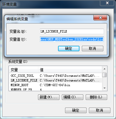

李风heart
Hi Razvan,
I added the lic file to the environmental variable like this:
But the situation remains the same.
5,143 Views
paulvlase
Did you restart Matlab after you added the environment variable? If not, please restart Matlab and try again.
5,143 Views
李风heart
I reboot my machine,but it still doesn't work.
