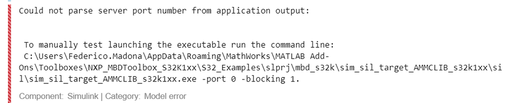

I am trying to run the Model Based Design Toolbox for s32k family. I correctly installed the toolbox into my Matlab 2019b. I set the license and the compiler, and tried to simulate an example to check everything works fine. I tried with SIL simulation, in particular the sine wave generation. Code generation works fine, but simulation is stopped with this message Shot.PNGI cannot understand the meaning of the message. Any ideas?
Thanks in advance,
Federico

Hello constantinrazvan.chivu‌,

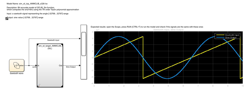

As proposed in the Quick Start guide to the toolbox, I tried opening the mbd_s32k_examples.mdl found in the folder. Cattura.PNG
From there, I opened the SIL block, and then the AMMCLIB sinusoidal signal generation.
When running the model, the code generation seems to work quite fine, but simulation stops with the error above. Is this the model you been asking about?

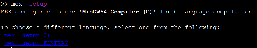

Can you run the following commands in the MATLAB terminal and share their output?
mex -setup
and
ver
Kind regards,
Razvan.

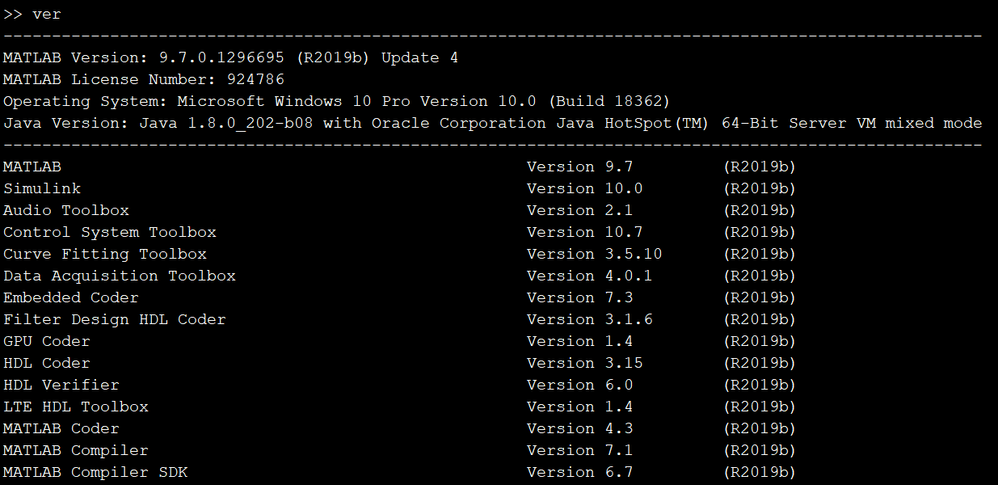

federico_madona
As for the compiler, I am only using MinGW64

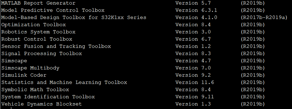

As for the versions, here is all
pastedImage_3.pngI just noticed that the MBD Toolbox is versioned R2017b-2019a, do I need to install an erlier version of Matlab?
6,431 Views
constantinrazva
Hello [email protected] ,
When we released our toolbox, the latest version of MATLAB was 2019a - this is why you're seeing that in the ver command output. It should be fine on 2019b, I even tested on R2020a, and it still works on my end, with the same version of our toolbox, same compiler as your. This being said, you don't need to install an earlier version of MATLAB.

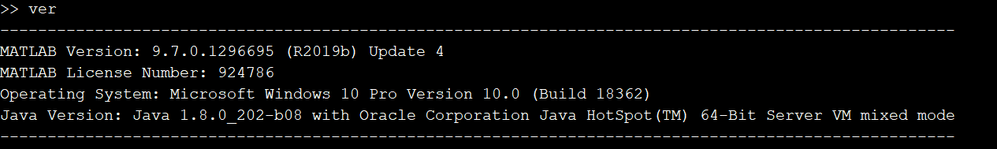

Not sure what to say here - we have not encountered this issue before and I wasn't able to reproduce it until now. Can you send me the whole output of the ver command (from MATLAB terminal) ? I'll try and replicate your exact setup. Moreover, can you also attach a text file with the contents of your MATLAB path? You can get it by typing path into the MATLAB terminal.

federico_madona
I attach the screenshot you asked me.
You can find the path.txt file attached to the message. Thank you very much
