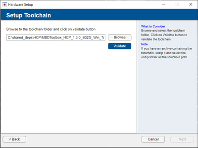

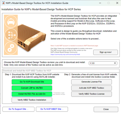

i have gone through the installation process following the guides provided by nxp and also using the MATLAB tool: NXP_Support_Package_HCP
I have gone through the steps as shown in the attached image.

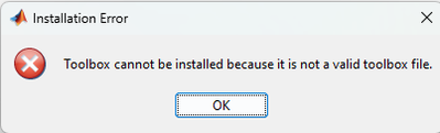

When trying to install the toolbox as a Add-On i get the following error message:
Toolbox cannot be installed because it is not a valid toolbox file.
Now i don`t know how to proceed. Is the file corrupted?
I need support regarding this issue as i cannot continue. Is this issue known? is it possible to obtain live support regarding this issue?

Hello @monchito911 ,
Is this the mltbx file that you are trying to install?
I tried on my side and it is working as expected. After you install this mltbx, you have to download the S32G Tools zip archive and from mbd_hcp.setup.guiSetupToolbox to set the path to the unziped Tools folder.

brianmckay
Hi @monchito911 ,
Take a look at the downloaded file. It's possible it has a .zip extension, which MATLAB doesn't recognize as a support package. Rename the file with an .mltbx extension and MATLAB will recognize it as a Support package and start the install process.

monchito911
Thank you for replying.
I was downloading the MBDToolbox_HCP_1.3.0_S32G_Win_Tools as the Name led me to believe this was the toolbox.
I just now realized that there is a .mltbx file on the bottom of the list:
SW32_MBDT_HCP_1.3.0.RTM_D2312
Thank you for your help!

5,005件の閲覧回数
monchito911
Hi @brianmckay,
As you can see on the first picture i have already gone through that step. The problem persists. I have downloaded it several times in case the file got corrupted while downloading or changing the extension. How to proceed?
