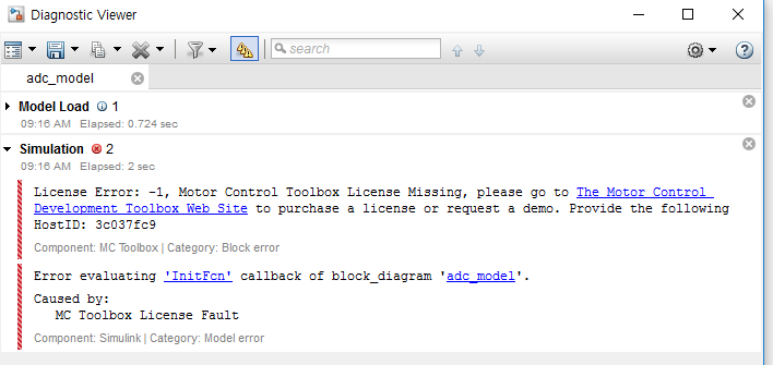

I have installed the motor control toolbox and set the path for Matlab.
I also downloaded the license.dat file and located the file in the following folder
""C:\Freescale\MC_Toolbox\mctbx_pnt\lic"
But when I run a example file, Matlab showed errors related to the license as below.
How should I install the license file?
Thanks in advance.

Hi Hyuntae,
   Please try to change the license file extension from '.dat' to '.lic' and try again.
Radu
