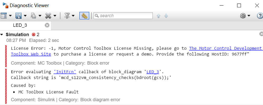

  when I use MBD ToolBox for MC9S12zvm,I encountered a problem as follows:
To deal with this problem ,I downloaded a patch program on nxp's community and added it to correct path.

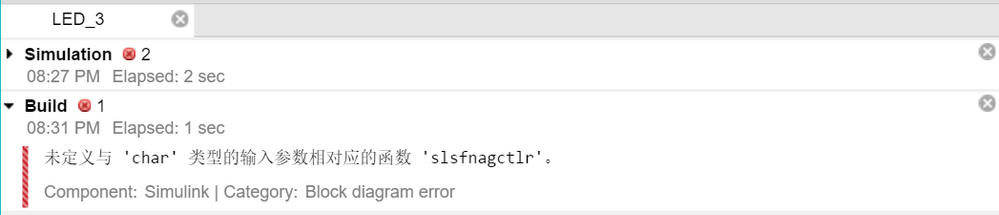

After this steps ,I run my module again.But another problem appeared like this:
Can somebody give me some advice?
Thank you very much!

Hello [email protected]‌,
You are having a problem with your MBDT license. You can take a look here (around 1'49'') - although this video is for another toolbox, the licensing part is the same. Just follow the steps from the video (for licensing) to generate your free license and you should not have that problem anymore. Please let me know if you are having problems watching the video or if after you generate the license it still fails.
Note: remember to run the mcd_path.p script if you haven't so far.
Kind regards,
Razvan.
