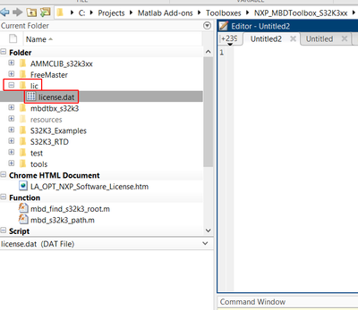

Hello Team,
I am facing the attached error. Can you please suggest on this.
Also find the attached dat file .

Hi, @Zuhair ,
Thank you for your interest in using our MBDT for S32K3 in your projects.
In the attached picture, I can see that you have selected the 1.2.0 version of the S32K3xx toolbox. The NXP Support Package for S32K3xx that you have downloaded from MATLAB Add-Ons has been updated to the latest toolbox version, which is 1.4.0. Following this, I advise you to download our latest toolbox, S32K3xx 1.4.0, from our NXP site and follow the steps from the Installation Guide again.
In case you want to continue using the old 1.2.0 version of the toolbox, you will need to manually install the mltbx package downloaded from NXP by opening it in MATLAB or by dragging and dropping it inside MATALB's command window.
The second step is to go in your MATLAB Add-Ons folder where the toolbox has been installed and take the license file download from NXP and place it inside a 'lic' folder in the toolbox root, as in the following picture:
I advise you to rename your lic file to 'license.dat' if you have multiple copies like the one attached in your post, 'license (8).dat'.
The last step is to run the 'mbd_s32k3_path.m' script found in the toolbox root. The script verifies the user setup dependencies and will issue instructions for a successful installation and configuration of the toolbox. Now you should have everything up and running.
Please tell us if these solutions worked for you, and feel free to ask any further questions.

@georgevictor  : Thank you very much for the detailed information . I want to continue using the old 1.2.0 version of the toolbox and tried the options but no luck. can we connect online ?

Hi, @Zuhair,
To use the 1.2.0 version of the toolbox, you need to follow the steps described in the previous reply. In case you encounter the same issue, I should note here that the S32K3xx Support Package from the MATLAB Add-Ons is no longer required.
In case you have encountered a different issue, in order to address it, I will need further information. A screenshot with the error could help me identify and solve your problem.
