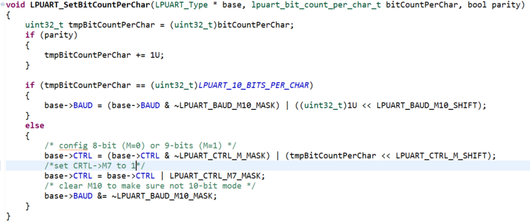

LPUART BAUD register M10 bit cleared
LPUART CNTRL register M7 bit setted
I modified the LPUART_SetBitCountPerChar() function on lpuart_hw_acccess.c file
ı just include  this 2 lines and delete other lines witihn this function for this experiment
base->CTRL = (base->CTRL & ~LPUART_CTRL_M_MASK) | (0 << LPUART_CTRL_M_SHIFT) | (base->CTRL & ~LPUART_CTRL_M7_MASK) | (1 << LPUART_CTRL_M7_SHIFT);
base->BAUD &= ~LPUART_BAUD_M10_MASK;
But i coulnd't get any expected data from LPUART Tx line

Senlent
Hi@engineer_attila
no,this should not work, you can modify it by setting CTRL register.

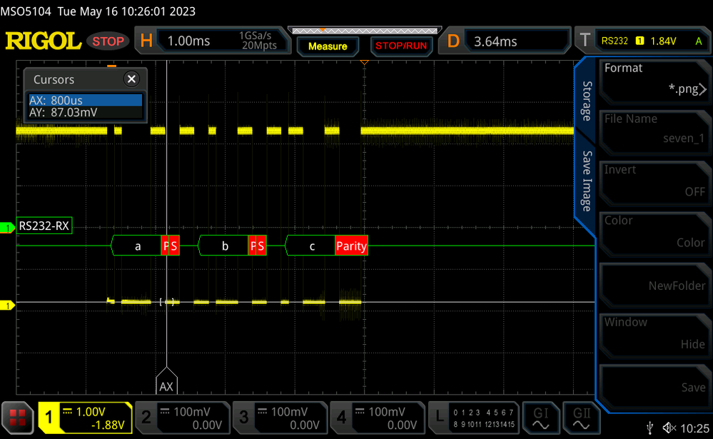

engineer_attila
Hi @Senlent
I changed the driver as you descirebed, send the string "abc" from s32k144 with 100msec delay. I got unreliable data from s32k144.
(It was changing over the time)
(Perceived data from serial convertor(9600-7-E-1 No Flow Control))
When i send the same string from serial convertor , i saw what i send
I search more robust solution for my problem

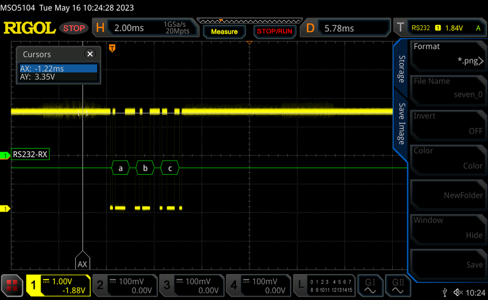

Senlent
Hi@engineer_attila
Will there be such a problem when sending a single character?
My test here is normal, but I didn’t use an oscilloscope to capture whether the configuration is correct.
You can test whether the single-character sending and receiving is normal.
It takes a while to test

engineer_attila
Hi @Senlent ,
My configuration
lpuart_user_config_t lpuart0_InitConfig0 = {
  .transferType = LPUART_USING_INTERRUPTS,
  .baudRate = 9600U,
  .parityMode = LPUART_PARITY_EVEN,
  .stopBitCount = LPUART_ONE_STOP_BIT,
  .bitCountPerChar = LPUART_8_BITS_PER_CHAR,
  .rxDMAChannel = 0U,
  .txDMAChannel = 0U,
and also change the LPUART_SetBitCountPerChar() function as you descirebed
I send a single character ('a')to the serial converter. I received from serial converter
0x61(a)  0x7F(DEL)

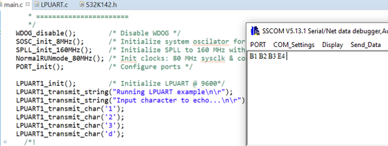

Senlent
Hi@engineer_attila
S32K-RM Chapter:
53.4.5.1 Data Modes
The LPUART transmitter and receiver can be configured to operate in 7-bit data mode by
setting CTRL[M7], 9-bit data mode by setting the CTRL[M] or 10-bit data mode by
setting BAUD[M10].
test.
send char "1" to PC ,"1" ascill ->0x31->0b00110001
PC will received hex 0xb1->0b10110001,bit 7 was set to 1.
this should be correct.
