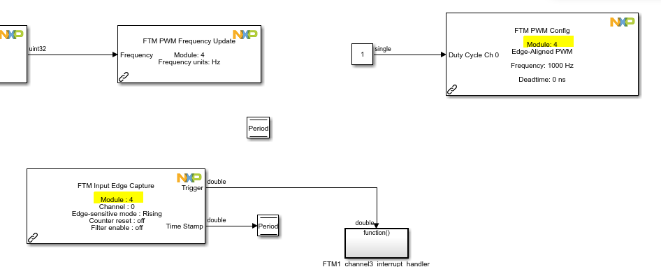

I'm using FTM blocks in my design but I can not simulate or build model when I use FTM Input Edge Capture block. Only this block give me errors. Can you please help me to solve this problem ?BeforeError.PNG

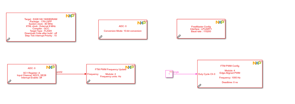

I have this errors with addition of FTM Input Edge Capture block.

The reason that this error is caused is related to the fact that you are trying to use the same FTM module, 4 same as input and PWM generator which is not possible in hardware.
The FTM module uses the counter in a different way for PWM generation than for FTM Input Edge Capture. Please select other FTM Module for FTM Input Edge than the module 4 and look after an appropriate PIN.

Thank you for your help, it works.
