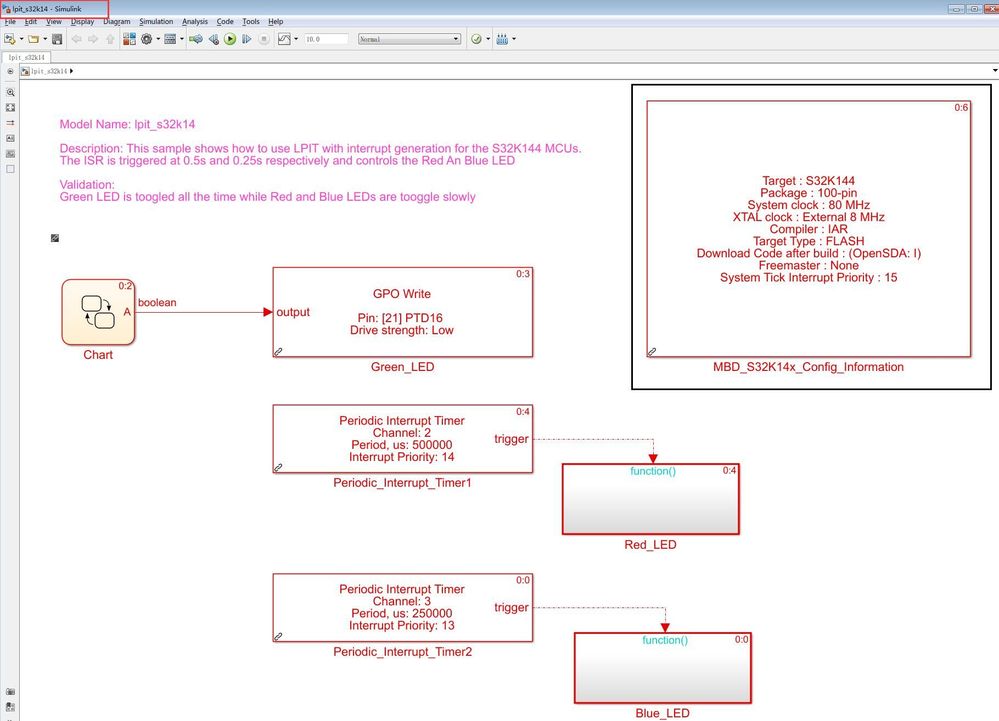

If I use this module generate  code,the clock was not 80M,and this was 100M.But if Iuse the a new “MBD_S32K14x_Config_Information” module from S32K library ,the clock was 80M,but the LED result wasn't right.

The processor works @80MHz or @112MHz

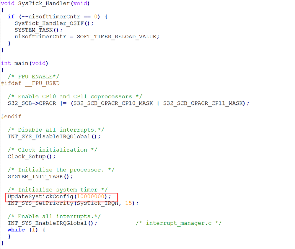

The initialization for the System Clock is computed starting from the CPU frequency value and sets the appropriate timers with the pre-computed value.
So there is no problem that you see the
/* Initialize system timer */
UpdateSystickConfig(10000000);

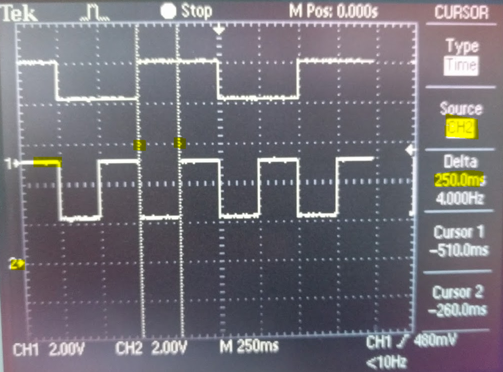

I've tested the application and the LED is controlled correctly based on the PIT settings: 500ms and 250ms respectively
These are the oscilloscope wave-forms.
(upper signal) CH1 = RED LED @500ms changing rate
(lower signal) CH2 = BLUE LED @250ms changing rate
As you can see the results are OK.
Can you share what you are seeing ?

There is nothing wrong. The processor is set to work @80MHz but the UpdateSystickConfig() is using the
Frequency->Ticks transformation, to set the RVR register to 10 000 000 ticks. This will in set up the MCU to operate at 80MHz.
